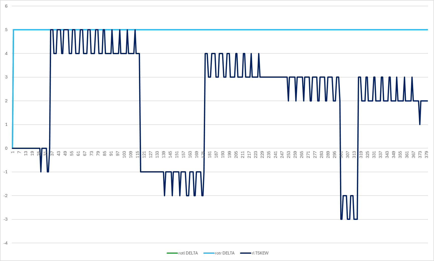

So one question here - can I use the relative timestamps between individual sensors (in this case rotation) as a reasonable estimate for when the sensors actually got updated relative to one another?
What I’m finding is that the changed callbacks all get called at the same system time for the three sensors, saying they’re being queued up, even though the timestamps for each sensor vary quite a bit relative to each other.
If I make the assumption that at least within the 10ms loop time things are not drifting too much, then the relative skew of the timestamps show how much the sensor readings need deskewing relative to one another. Also the callback system time then would place a lower bound of how long ago the sensor readings were updated.
If that makes sense.
Graphically here I’m showing the time delta between the current system time at the start of the sampling loop and the time that the changed callbacks get called. These are basically constant at 5ms. These are the “rotr DELTA” and rotl DELTA" lines (showing up as one light blue line). The difference in timestamps between right and left rotation sensors (“rl TSKEW”) in dark blue however bounces around quite a bit (-3ms to +5ms here).
Note this was taken from c++ with 5ms overide for datarate. Sampling loop still at 10ms.

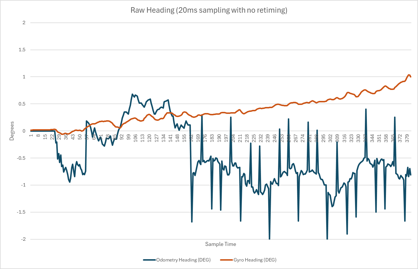

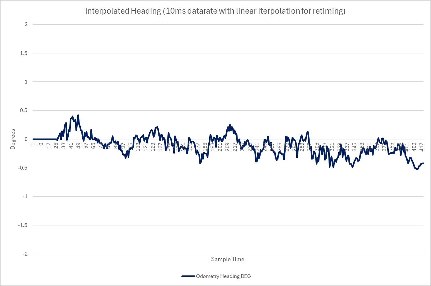

The main odometry loop then runs at 10ms and uses a filter (linear interpolation for now) to retime/resample the readings. Results for a robot driving straight for 1m below. This is only the heading part of the calculation.
First Chart: This is where I started with 20ms datarate and no interpolation. You can see the discontinuities where the sensors switch relative places in time with one another. The gyro is included here as a reference. All values in degrees.
Second Chart: 10ms samples with linear interpolation for retiming. Still a bit noisy, but much improved. Sorry no gyro here.
