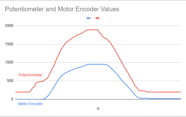

I use a potentiometer in conjunction with the motor’s internal encoder values. The potentiometer determines the stopping and starting positions, while the internal encoder’s value is mapped to a specific velocity. For example, if the tray is tilting upwards, and the internal encoder value is 400, then the velocity of the tray is 40. You can experiment with different continuous mathematical functions to find an appropriate “mapping” curve. I do this by representing the x value of the function by the internal encoder’s value and the y value by the output velocity.
So why not use the potentiometer to map the velocity of the motor? The potentiometer does not return perfectly linear values. Meaning a rotation from 30 degrees to 60 degrees could change the pot’s value by 150 while a rotation from 60 degrees to 90 degrees on the same pot could result in a change of 120. If the sensor was perfectly linear, then a 30 degree rotation of the sensor would change pot’s value by the same amount. See the jerks in potentiometer value below:
comparison_internal_pot
A potentiometer is really just an adjustable electrical resistor, so by turning it you are just changing the voltage that it detects. This method of measurement results in the slight error in the linearity of potentiometers. I tried to use a pot as the input of my mapping function, but as expected there were lots of random spikes due to its non-linearity. Considering you want the tray motor to move as smoothly as possible, using the pot values mapping the motor speeds is not feasible.
Another reason I use both sensors in conjunction is because the pot always measures the absolute position of the system however, the encoder value is only relative to the system’s position at the start of the program.
Understanding how each sensor works, and their strengths / limitations helped me determine the best way to implement each sensor to my advantage.

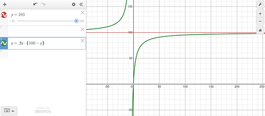

No you wouldn’t; if this were the case, then we wouldn’t be recalculating error every iteration. A constant slope would mean that both kp and error stay the same the entire time. Instead, error progressively gets smaller (or larger if it overshoots) making it an exponential graph with an asymptote at target.
@Anomalocaris
A constant slope and constant error would have 0 slope. A downward sloping line has a constant slope which is mathematically the kP.
Using the equation:
And 6 discrete points, you can see that it is a:
As you can see the error gets smaller as it gets closer to the target, and it gets scaled by a factor of kP. Mathematically, a proportional relationship will never have asymptotes.
I encourage you to find the slope between each of those points. You will see that each slope has the same value of kP, which proves that it is a downward sloping line (with a constant slope). Further confirmation that there is no asymptote is shown by the final point which represents overshoot because it is greater than the target value.
Your graph is subtracting the x value at each point from the y target, however, in this case, the error would be the y target - the current y position. The graph would look something like this:
The equation you graphed is not a proportional relationship. Nor is it is the same equation you pseudo-coded in your previous post.
I should not have called the target value y_target, that makes it confusing – my mistake. To clarify, all the numbers on the x-axis represent the sensor values. This includes the current sensor value and the target sensor value. The numbers on the y-axis represent the output value of the calculations provided above. Based the code example you provided above, it would result in a proportional relationship. Which looks like this.
I can justify that my coordinates are correct because the input and target values are on the x-axis, and the error calculation (which gives the output value) is on the y - axis.
Perhaps in that case the slope is constant. However, my graph is a representation of just the sensor value relative to the target value. This is a one dimensional situation, so me graphing it on a 2D plane makes x time. All of the values in the 2nd and 3rd quadrant are impossible because you can’t have negative time, leaving you with just the graph of how the current value is driven to the target value, assuming target is 100 and kp is 0.2. I think we just misunderstood that we were describing different graphs.
