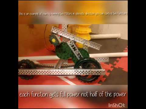

@antichamber I bet you could figure out a way to make a 2 motor holonomic drive with all the jank stuff you’ve been going recently
for all we know he has already invented 1 motor holonomic drive using some strange transmission
This would be cool, however I think it’s actually impossible since motors only have 2 degrees of freedom, and holonomic drives would need 3 degrees of movement.
Just have 3 modes for the transmission: x, y, and rotation. If you need to do more than one at once switch between them really fast /s
theoretically, if you can switch between all of them extremely fast, you can use all of them at once

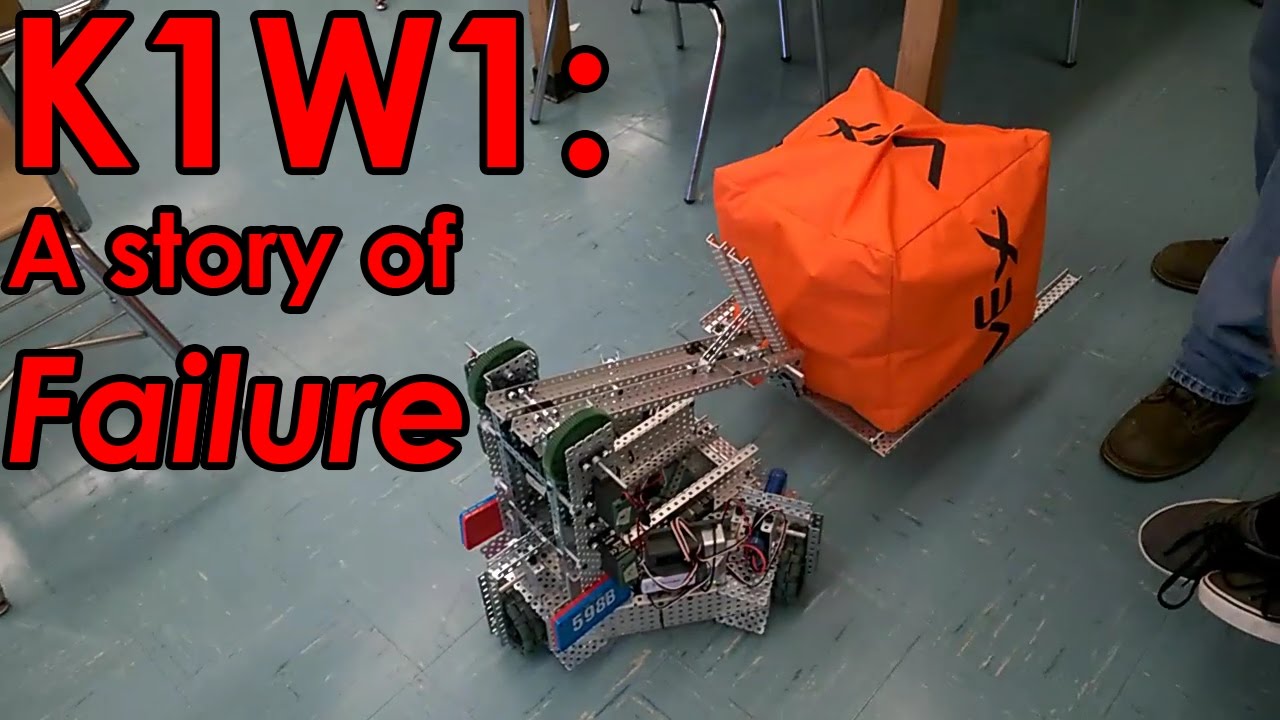

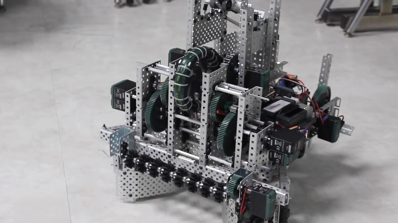

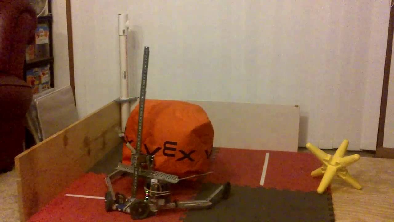

He was not the original designer of the system. However, he has made several public iterations of the system. The original drive mobile goal differential system was prototyped over the summer by @technik3k. He actually showed my team a sketch of the system and left us guessing for some time about how it would work. Last season they developed a slightly different, single motor differential that could lift, dump, and hang. It was a just a prototype that never saw any competitions, however.
@antichamber Should be given a lot of credit for being the first one to take the differential design, and build it for themselves. He has been an active participant in helping improve the design and was willing to share all his failures and successes with the design online. I believe that he is also responsible for motivating @technik3k (and many other teams) to continue to improve the design instead of dumping his differential like last year.
I’m really excited to see what they can do with V5 or transmissions next year!
