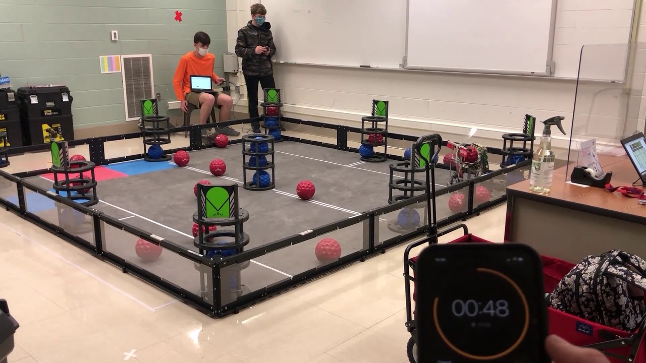

Here’s a video of some of my skills runs so you can get an idea
