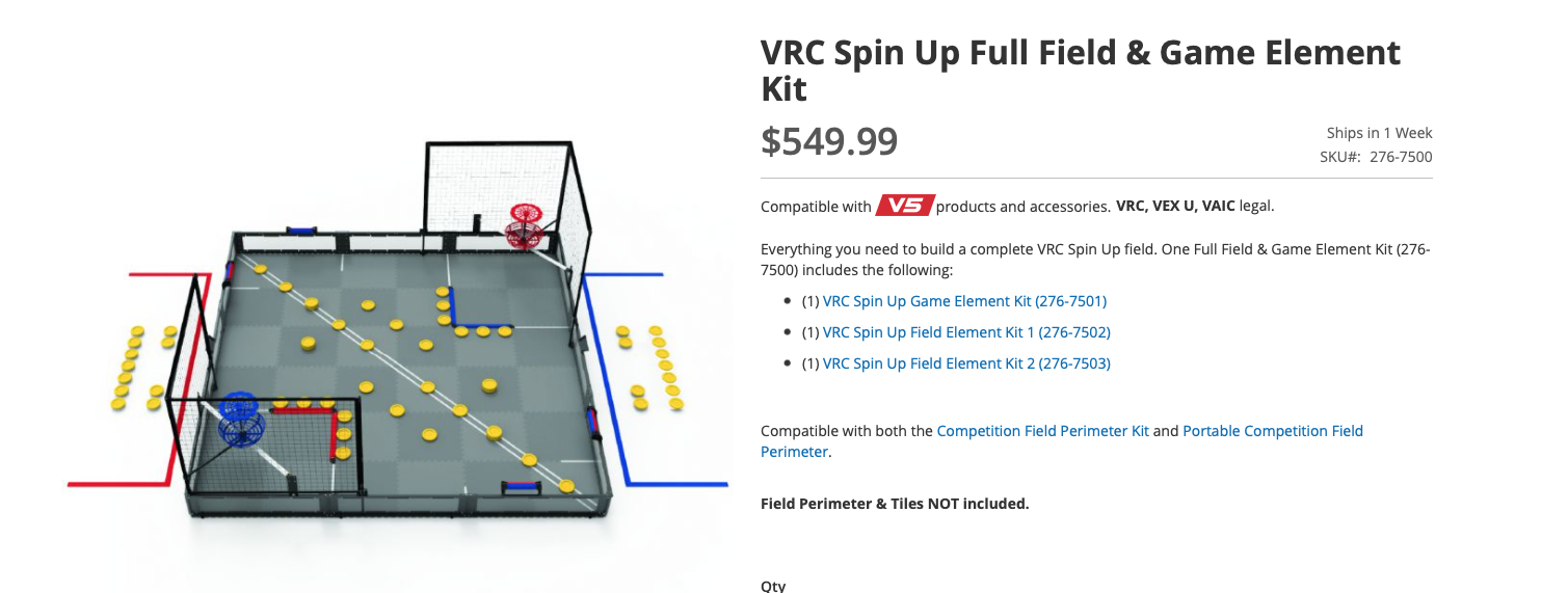

So I was scrolling through vex V5 product pages looking for cool things that I could use and saw this and thought it’s listed as legal that’s funny.
Then I kept scrolling and all the field elements are listed as vex legal.

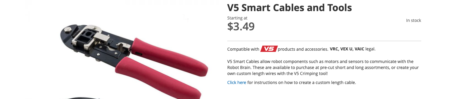

Can I use the crimping tool as a part of my robot?

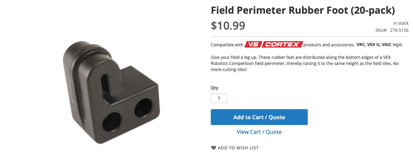

Or how bout the field brackets?

yo, lemme just pull up during Spin Up endgame with an expanding Tipping Point platform
forgot to mention that the whole field for this year is VRC legal as well.

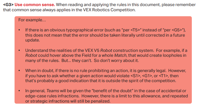

Got it so I can’t read, but this does beg the question on why these parts are specifically listed as VRC legal. There is also the fact that in the way the red box is written field elements don’t apply, they are not Vex apparel, could be considered competition support materials, not packaging, and it is for robots.
Plus the game manual is contradicting its self.
Red box under R6
Using VEX apparel, competition support materials, packaging, or other non-Robot products on a VEX Robotics Competition Robot goes against the spirit of this rule and is not permitted.

So sad we cannot use VEX cable cutting and crimping tool as a legal legacy claw replacement. :wink: :wink:

does that mean that the tipping point plastic is illegal even if it is a custom-made part?
That’s a good point. We frequently used the flags from turning point for custom polycarbonate parts. We were never challenged on the legality of this. I guess unless there’s something I’m missing, the flags (and the platform top polycarbonate pieces from turning point too) are illegal.
The flags from turning point are neither legal nor illegal because they are field elements, but because the material they were made from is a Vex legal plastic, that is polycarbonate less than .070 in thick, the flags can be used as a source of Vex legal material.
