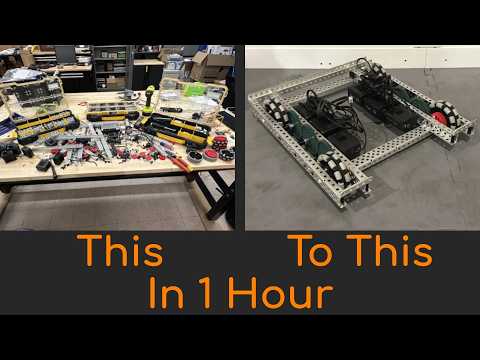

I have a couple youtube videos covering drivetrain construction you might find helpful.

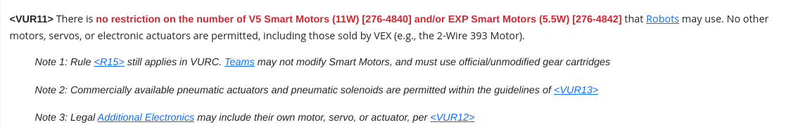

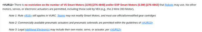

In VEX U the most popular drive I’ve seen (I could be wrong) is 8 motor 600 rpm 2.75inch wheels. The easiest way to do this is on each wheel connect it to a blue motor, some teams don’t even gear them all together. As long as you can drive that it will be good. If you want a slower speed look into 450 on both 2.75 and 3.25, or 480 on 2.75

For a VEXU team, consider using more motors for your drive, as it gives more power to the drive and you could still power share between the intake and conveyer. There isn’t a limit to how many motors you guys can use.
