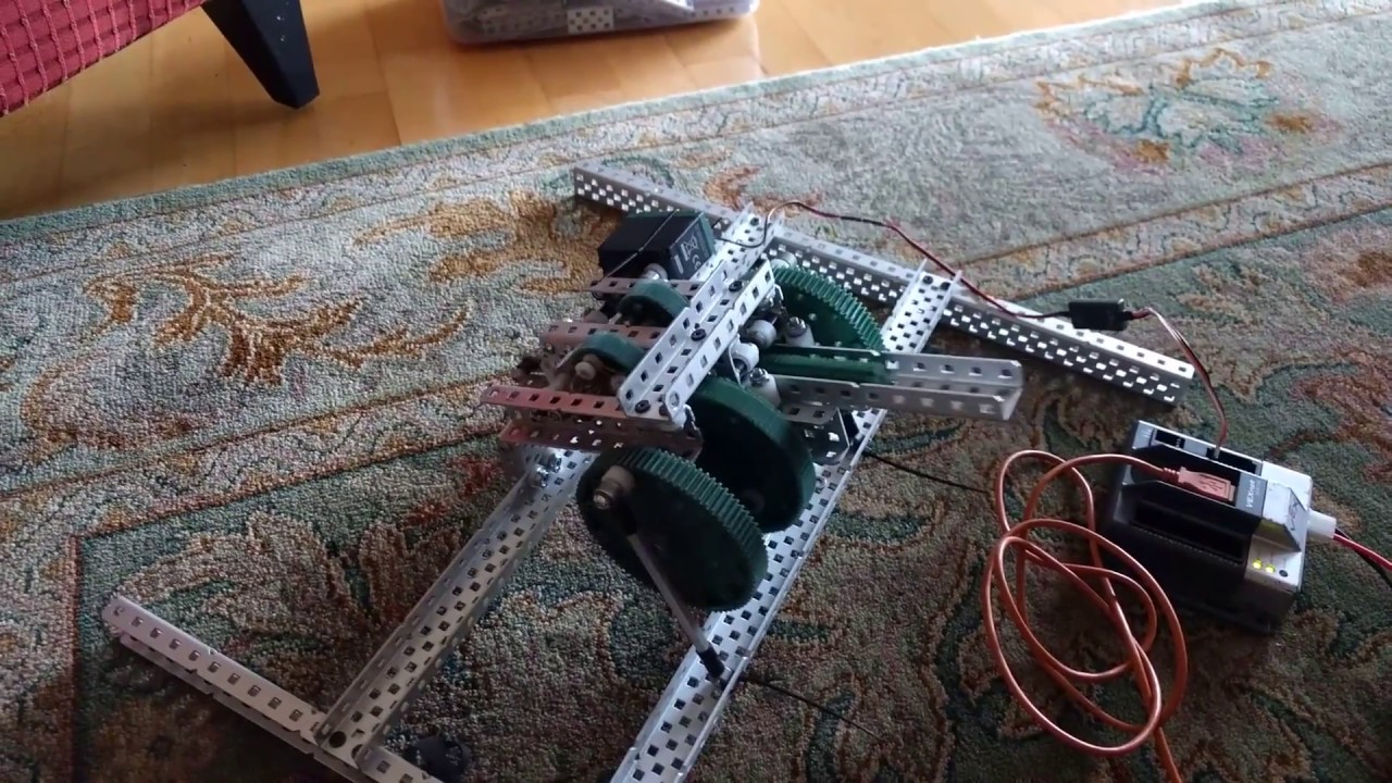

Here is a great example of employing ratchets to build an angle changing puncher with just a single motor:
However, you have to be cautious which functions you connect to the shared motor. In the above example you would first need to set the angle and then wait for the puncher to pull back all the way before shooting. This seems like not a big deal, but during the match every fraction of the second counts. You would need to add another ratchet that could keep the puncher pulled back at 90% and only needs to go remaining 10% of the way when it is time to shoot.
Ideally, angle changer for either the flywheel or puncher needs to be powered by the motor shared with the function that is idle while you are launching the ball.

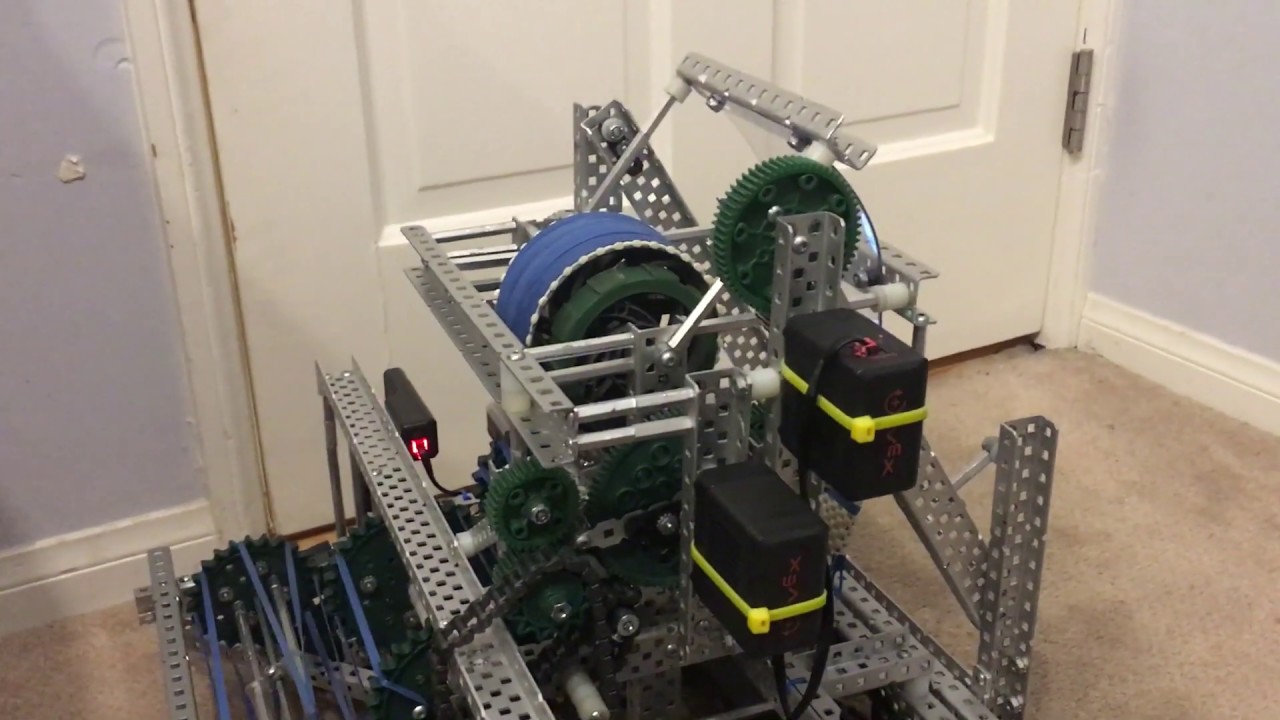

Here is an example of sharing intake and indexer motors :
But this could get complicated fast and you may lose your ability to flip caps by running the intake in the opposite direction.
The alternative could be to share the motor between intake and the angle changer. You could permanently link the intake with the angle changer cyclical motion. When you run intake you don’t care which angular position the backplate is in. Then when you ready to launch the ball you just stop intake when the backplate is at the proper position and launch the ball.

You should still be able to run the intake backwards if you put a double ratchet on the intake as opposed to that gear friction whatchamacallit on the reveal you linked.
