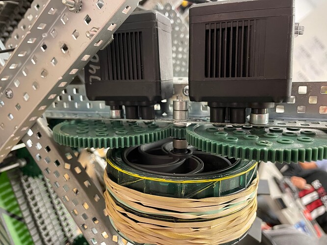

Aight so Im tryna make a flywheel to launch disks and i cant figure out a way to make the wheel spin fast enough. i have two motors connected to one wheel, but i realized that that only increases the torque. any ideas? thanks in advance
Use searchbar plenty of topics on this but if you cant search… 5:1 on a blue cart (60t gear (motor) 12t gear(flywheel)
Using a 5 to 1 or 7 to 1 gear ratio(big gear on motor, smaller gear on the flywheel) seems to be the current trend, and would work single or double motor. Double motor would help the wheel spin up faster and allow for shooting more frequently, as well as making friction control less important. Blue motor inserts.
I should have mentioned that this is what i currently have. Those are blue motors by the way
