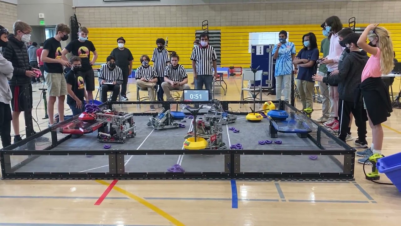

In this Match, my team was intentionally pushed into the opposing teams platform while I was attempting to maneuver the field. This resulted in a 30 points being added to the other teams alliance causing them to win the match. I am just curious if the refs made the correct call here and I would also like to hear other people’s opinions on the matter.
https://youtu.be/EShErylq3ME?t=132

It looked like the call could have gone either way - 30 points awarded, or ruled that the robot-to-robot interaction actually caused the robot-to-platform contact. The Red robot had little to gain (and much to lose) from being in that position at that time. The fact that it drove so close to the platform in the last 30 seconds opened it up to a ref’s judgement call. Why put yourself in that position?
The fact of the matter is that I had no intention of contacting the platform, however another team forced me into contacting the platform, so my team is just trying to clear things up.
from the video it is quite difficult to tell that your robot was pushed into the platform, because of how close it was and how it was already moving in that direction when your opponent contacted you. And referees don’t have the luxury of carefully watching footage after the fact.
I don’t think the referee made objectively the wrong call, this is clearly a fuzzy area of the rules, especially when the interactions are this subtle and fast.
I can see where your coming from, but let’s say my robot was sideways and I got pushed into the platform. Would the judges still award them the 30 points?
I think the real question is: Why put yourself in a position where your actions let the referee determine the outcome of the match?
At the end of the day, the Head Ref made a call. Re-litigating it in the forums won’t change the outcome. You can change what you do in similar situations in the future, however.
Unfortunately there would still be a penalty, it’s any contact.
The 30 point penalty call was warranted. You took a path between the other alliance and their platform to try and obtain a mogo. You put yourself at risk of the penalty, when you had the option of driving the long way around to make the safer play.

the same could be said of @Julian9181’s match actually, but because the interaction was so brief, and it would be nearly impossible for any referee to be able to tell if the interaction was forced or not, the ruling as it was is a perfectly reasonable one.
I think the refs made the correct call. I don’t like the rule, but if is fairly clear.
For the purposes of this rule, supersedes rule . Any Robot which is contacting its own Platform during the last thirty (30) seconds, provided that no other rules are being violated, will automatically receive the “benefit of the doubt”. Therefore, any contact with this Robot will be considered a violation, regardless of intent.
Since you touched the platform, you committed an SG3 violation.
I’m not trying to change anything I’m just trying to clear it up for next time.
It looks like in this instance the blue robot was NOT contacting its own platform - therefore the blue doesn’t automatically get the “benefit of the doubt” and instead the ref needs to determine who the offensive robot is to determine who gets the “benefit of the doubt” for questionable rules violations, right?
I agree that the call was reasonable and perfectly understandable; I also think that it could have gone either way (depending on how the ref saw it). G13 may supersede G14, but here it is unclear who the offensive robot is - “generally” the blue carrying its alliance goal would be, but I think there is a (very small) case here that the red attempting to get the neutral is more offensive than the blue that pushed it into the platform. Therefore, if I were a team trying to discuss this interaction I would be trying to POLITELY convince the ref that the red is the offensive robot and to look to G14 instead. The ref has to make this call in a very short amount of time based on a very quick interaction, though, and it seems more likely that they would call it as a penalty on red.
In @Xenon27’s video, it looks much more likely to be a G14 violation. The red robot, IMO, appears to be the offensive robot; it is clearly going to get (and does appear to almost grab) the neutral goal, it is before the 30 seconds start, it is being pinned by a blue who is not touching its own platform and not carrying a goal and who appears to be pinning red to the platform intentionally.
I think the moral of the story really comes down to… for next time, try not to put yourself in a situation where this comes up. The area around the platforms is a dangerous area to be in during those last 30 seconds (or right before), especially with opponent robots around; like @9MotorGang, I don’t like the rule (at least not to the extreme that it is written as) … but it is definitely a rule, and you definitely touched the platform, and in most situations you definitely will get penalized.
According to transative contact, which is a giant thing when dealing with the platform, yes, the blue robot was contacting it’s own platform. G13 superseeding G14 is honestly really dumb, and shouldn’t be a thing, even though I do get they want people away from the opponents platforms more than anything else.
