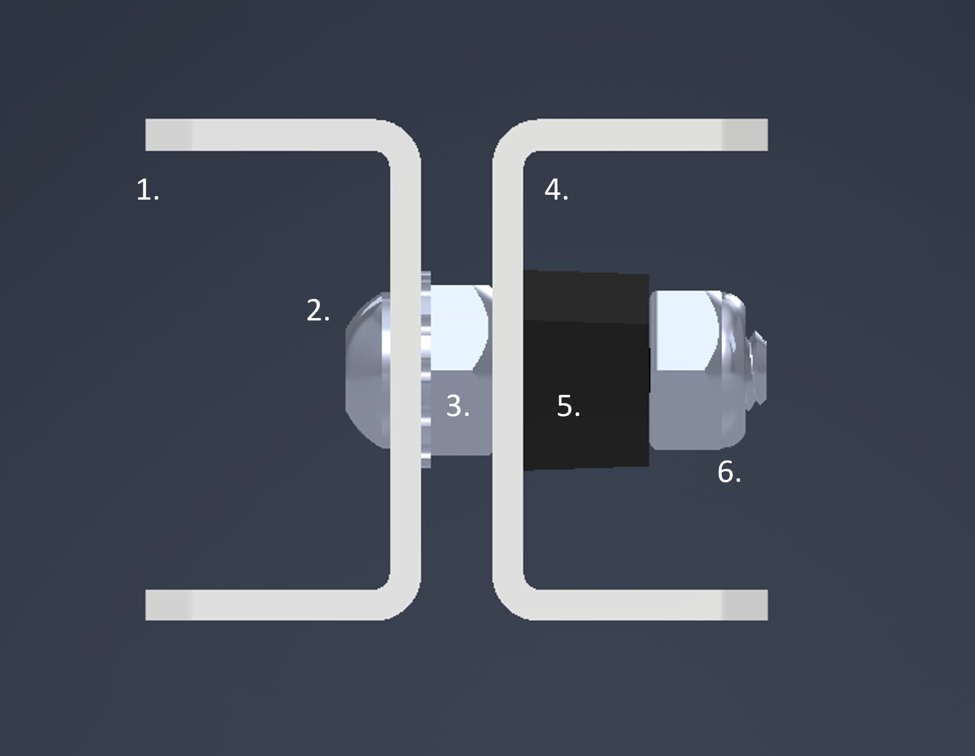

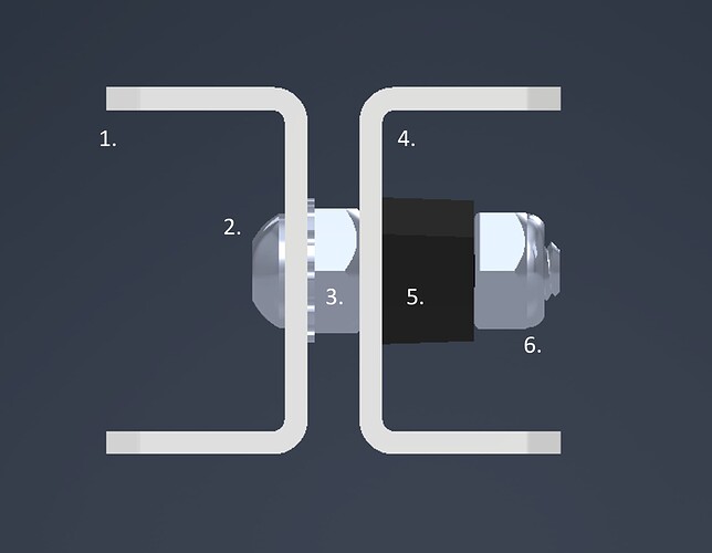

Could someone explain what a screw joint is and possibly send a picture
Rather than using a shaft to attach a rotating joint, you can replace it with a screw. Due to the fact that screws are cylindrical (roughly) rather than having a square cross-section like a shaft, they can cut down on friction significantly. It also helps that they are closer to the standard vex tolerances for joints and fit ever so slightly better within a delrin bering flat. I don’t have a picture currently, but I’m sure someone else does.

there are so many types of screw joints here, what kind is SeanMoody talking about, and I don’t get how these where there would be movement to cause friction when it just holds two pieces of metal together.
a screw joint when it comes to wheels/gears means simply bolting a long screw onto the hole you want to attach the wheel/gear to, using a keps nut to lock down the screw into that hole, put the gear/wheel onto the screw using a free-spinning insert or drilled out center so it can freely pivot while the screw stays steady, and then put a nylock nut or spacers to hold the spacing right. Like with all joints, don’t overtighten the spacing.

Finally, by screw joint, I mean something like this picture from the BLRS wiki. The only thing I would add is that I find the bearing on the screw head side helps more as it lines the screw up before it goes through any metal. If you do it like this it shouldn’t need a bearing on the nut side as your aligned chassis should mean that the screw is in the middle of the second c-channel hole already making a bearing unnecessary.
