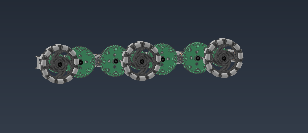

Ok, so here’s our issue. We only have 200 RPM motors, not 600. We are gearing it at a 5:3 ratio so the motor is connected to a 60T gear and then that connects to a 36T gear where the wheel is at.
So here’s what our potential drive train would look like -
(wheel and 36T gear) + (60T gear and Motor) + (36T gear and wheel) + (60T gear and Motor) + (wheel and 36T gear)
This reaches the desired RPM with minimized gears and friction but is too clumped together and doesn’t stretch over the full span of the chassis. The drivetrain is very central and doesn’t take up the full space allotted for the chassis.
What we wanted to do to take up the right amount of space is add 1 36T gear on each end of the chassis to stretch it out. What ended up happening is that the wheels are now going in separate directions (the front and back wheel are going one way, but the middle wheel is going the opposite way.
We decided to add 1 more gear on each end of the chassis but it’s elevated higher up to not take up much more space but to change the direction of the back and front wheel so that the back middle and front wheel all move synchronously like Sequam Robotics bot (attached).
IMG_5372.pdf (2.7 MB)
This would all be avoided if we had 600 RPM motors and idk what to do

What are your thoughts on Sequam’s chassis? It seems like they have 9 gears as well.
The chassis is linked in my last post
It looks like they pulled it off pretty well. They were using 2.75" omnis, while it sounds like you are using 3.25 omnis. That means that they had to spread theirs out further than you will have to.

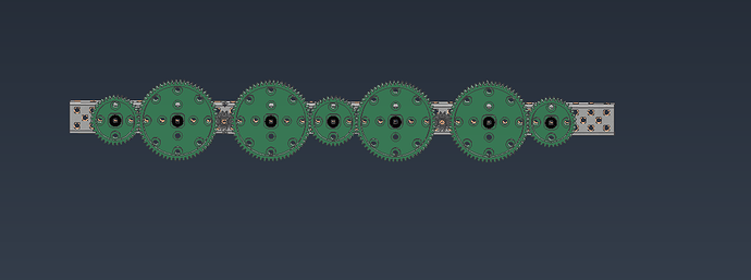

Could something like this work?
Additionally, is there a reason you need the geartrain to span the whole 35 holes? can you not make your drive 30 holes long?
30 holes is fine, our first design was very little tho. We want some space in the front so that we can cut a little bit of the c channels off and create a dustpan like shape to allow more discs to get picked up where the intake is.
This design is great, but I’m not sure it gives us that space in the front.
But thank you so much for this design tho, it’s currently our best (and only) design that meets most of our needs.
We felt that with more spread out wheels, the robot would perform better and would have better distribution of weight but we may be wrong!
Also, this still has the 9 gears issue right. We would be willing to spread the wheels out less as long as it still has a good distribution of weight if we can get it in 7 or less gears. Any ideas?
Try to avoid the 12t pinions in drivetrain, they add a lot of unnecessary friction.
Chain could be used to solve the problem of the front wheel not being powered, while still having a gearbox in the back of the robot.
Use a 5:3 ratio with motors at the front and back and use chain to connect the two sections together.
