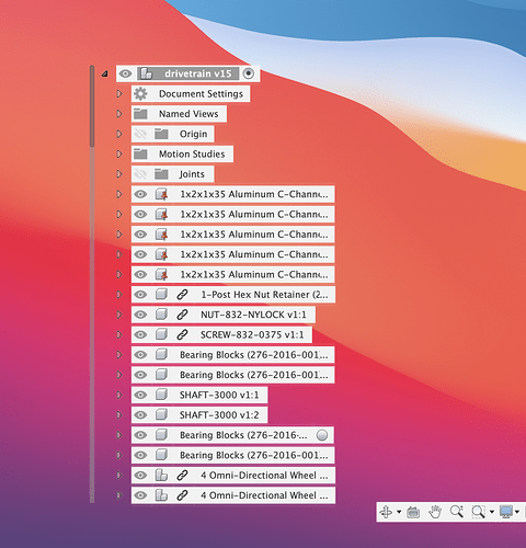

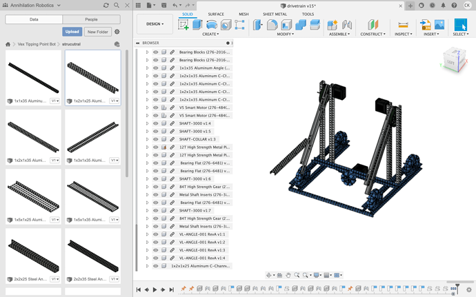

I’ve been having this issue from the very beginning with Fusion 360 - it seems like it has always frozen up on me. Here are some screen shots of the project I’m working on right now - but it froze up even when I was doing smaller projects too.
It is also leaving the parts list over the top of any other app that I pull up even after I’ve closed Fusion.

I use a Windows machine with 6 cores /12 threads and as the complexity increases, it starts to freeze whenever I add another part or change a parameter. I just learned to ignore it, but there was no real solution I had to get it to be smoother. (I believe there is a way to reduce visual quality in favor of performance.)
As @cougarbots mentioned, you can try Onshape or even find a way to blow air over the bottom of the laptop to keep it cooler and hopefully run a bit better. You can also try this.
I too would suggest using Onshape, but if you are partial to F360 (like me) there is a browser-based version: fusion.online.autodesk.com. I was unable put in the add-on for changing part lengths by holes from here into the browser version, but from the screenshot you added it looks like you do not have it, so that should not be a problem. Hope this helps!
