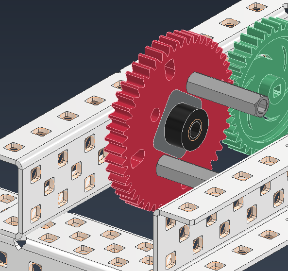

Would using a spacer like this, with a wheel on the other side work to hold the insert in?
Both sides would be constrained so they couldn’t slide around or anything.
I very much doubt this would work, the metal core would be able to wobble and it wouldn’t have very much depth in the gear. I think if you’re going through the trouble to shave down the gears, may as well do it right on both sides.
I’m trying to design a 450 rpm drive on 2.75" wheels, with 6 motors and 6 wheels. I’ve only got 8 48t gears for it though, 4 of which are currently on another robot and need to be kept intact, so can’t be shaved. So I’d like to cut them down in a way that I can get 2 thin gears out of each gear.
Do you think that sandwiching the gears with lockbars would be effective enough at keeping the hubs in?

you don’t need thin gears for 4 wide gaps
also pinion on drive is bad
more friction
you should probably do a raised 36t idler

I use screws/standoffs to attach the gears to the wheels, which I have found run into screws used on bearings/motors, making a 4 hole drive with 48t gears and the thicker omni wheels harder.
I’ve tested it, it’s really not that bad.
Hang on, I figured it out:
if you need more room, it’s pretty easy to drill little counter-sinks in the gear flanges so that screw heads don’t stick out.
I actually think it’s really annoying vex designed these gears with the flanges flush to the edge, would have been nice for screw heads to fit without needing to drill.
