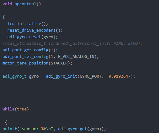

Hi gusy so i was tuning the values for my pid and the gyro suddenly stopped working. Does anyone have any ideas, this is the only gyro we have and almost all our auto is based from a gyro. Does anyone have any ideas. Please help!!

The way i am reading and initializing a gyro is like this image
  1. I tried that and the value is still going up slowly

What are the values you’re seeing printed?
it usually starts from -.958364 and then starts going down slowly but now its going up really fast and i changed nothing but the port. @edjubuh
The gyro requires a couple seconds of calibration when it starts. Are you leaving it completely still when the program starts?

I’m not sure what’s going on then. The gyro driver is implemented in VEX firmware and not by PROS. What do the values look like if you configure the gyro as an analog input and print the readings?
arent the gyro values already in analog input? @edjubuh

If you meant doing it like this printf("sensor: %d\n", adi_analog_read(gyro)); then it gives me a value of 2147483647. @edjubuh
That would be the designated constant for PROS_ERR. add another printf right after: printf("error: %d\n", errno);
