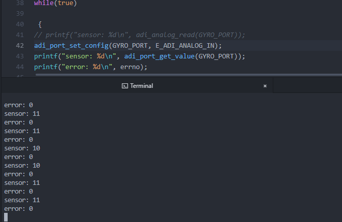

@Sgarg14 Do you have the gyro ADI port configured as an Analog Input or as a Gyroscope still? If you try to poll the port as an analog input while it is configured as a gyroscope then it will return PROS_ERR (2147483647) . The errno value of 0 is expected for this case, although that is different behavior than other such mismatched configuration errors and I will be updating that for the next release.
@edjubuh Do you mean like this?
printf("sensor: %d\n", adi_port_get_value(GYRO_PORT));
and
adi_port_set_config(GYRO_PORT, E_ADI_ANALOG_IN);
Make sure to put the adi_port_set_config() call before the printf, but yes, that should work for printing the analog value sent from the gyroscope.
@edjubuh this is whats happening now
it just switching between 10 and 11 and nothing happens when i move the bot

What does the V5 dashboard show if you configure that port as analog input ? It should be around 1800 when stationary.
it shows around 4000
And if you unplug it ? Is the gyro green led on ?
If i unplug it the values go crazy and yes the green light is on
ok, this feels more like a bad V5 port. The port should show close to 0 with nothing plugged in. Have you tried another port ? Do you have a potentiometer or something else that you can use to verify the 3-wire port is working ? Do you have sensors plugged into any of the other ports ?
