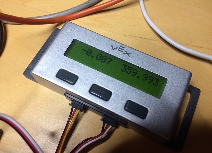

So after doing that, this is what I see 10 minutes after calibration
drifted less than 1 deg

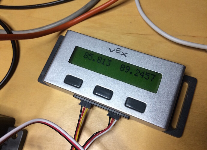

and if I rotate 90 degrees
seems pretty good, value on the right is finalGyroValue which I assume is your output.

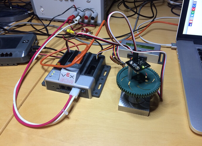

Here’s my setup, I mount the gyro on square steel block to help get accurate 90 deg turns.
Thank you so much for taking your time to actually test my code.
I probably should have specified though, because when I was saying drift I meant over time of driving it around. When I leave it there, the drift is minimal even over long periods of time. The problem is when I drive it around and turn it in circles several times. That’s what I’m trying to reduce because I’m working on position tracking code. This needs to be very accurate for my purposes.
One of my ideas is that since the constant I multiply by isn’t perfect, it might read 179.5 degrees on a 180 degree turn. Then, if you turn the robot completely around 10 times, it would be 5 degrees off. Keep going and the error would keep increasing. My plan is to try to perfect the constant, but if anyone else has any ideas, I would be very grateful.
For this gyro that seems pretty good to me.
How/where is the gyro mounted on the robot ?
