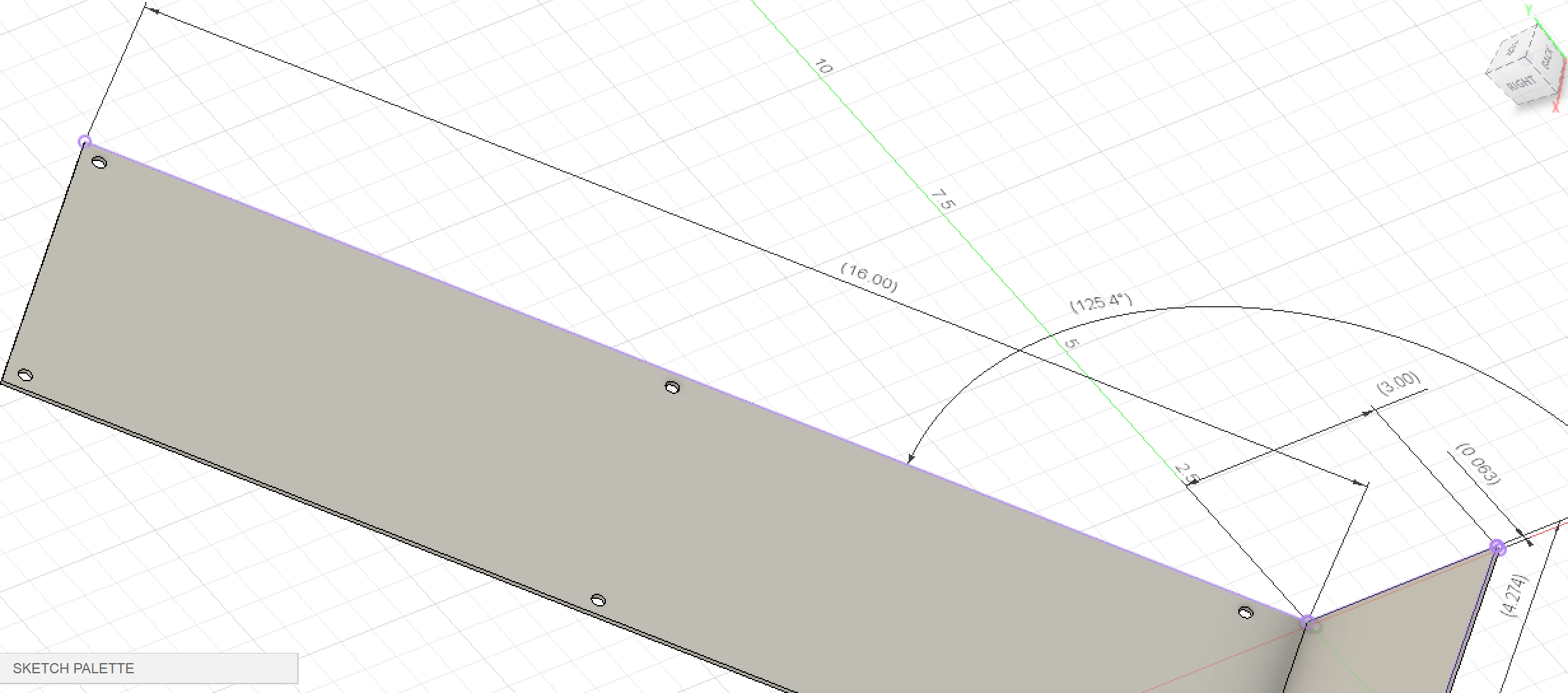

We are thinking of building Amogo and we are looking through the pieces and we saw the piece “lexan for conveyor,” and we saw that it is a type plastic, but does anybody how what size it is?
About 19" by 4.3", 0.063" thick and with a 125.4 degree fold. It’s worth examining the CAD in detail.
