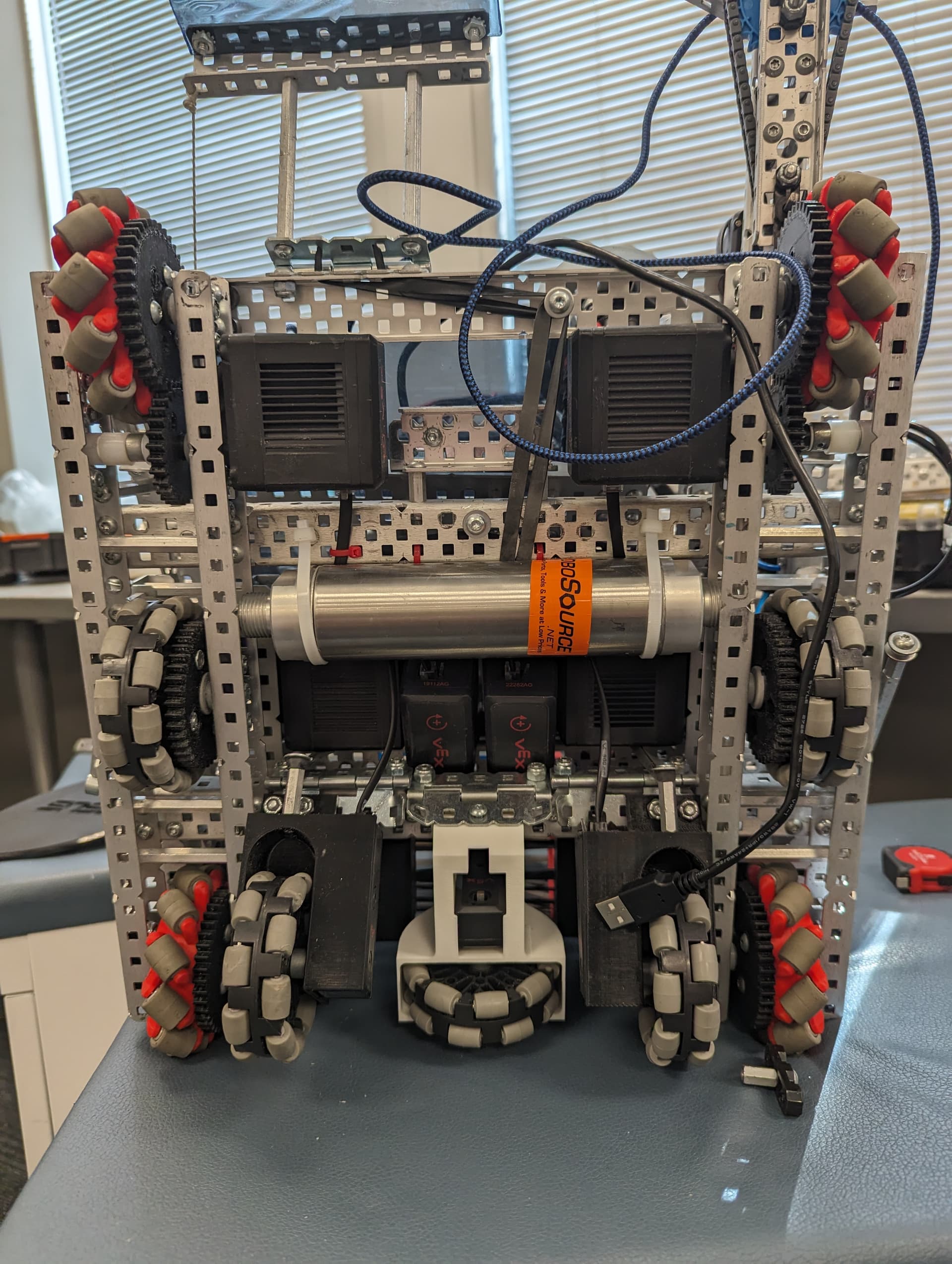

One of our robots does something similar. It uses mechanum instead of x and has custom gear ratio.
The drawbacks are that it uses 6 motors, which isn’t a problem for us because we have unlimited motors. We are using 3d printed mechanum wheels because vex 's are massive, and we are using custom gears to get 420 RPM.
It’s a cool concept and it does work and it has significantly more force going forward and backwards as opposed to strafing because the two middle wheels don’t move while strafing.

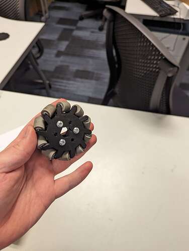

Sure! So I designed the mechanum wheels to be vexu legal at the beginning of the season, so they use the 4" Omni rollers as the mechanum rollers. They are 3.25" so the work with the other 3.25" Omni wheels. Unfortunately, because of the awkward size of the rollers, I can only fit 11 around the wheel.
After the allowing casting for VEX U, I have adjusted the model to work with 12 rollers so that assembly of the mechanum wheels is easier. We also designed a mold for the rollers so that the rollers have a curvature that makes the mechanum wheels completely circular.
Right now, the mechanum wheel prints in two parts and you put the pins and Omni rollers on one half. Then you can screw the two halves together. Because there are 11 rollers around the wheel and 6 screw holes, there is only one position where they align correctly. With 12 rollers, the two halves should line up in any orientation.
Here is a 3" mechanum up close…Had some fun ideas for it, but using them with the 3.25" omnis was more practical.
