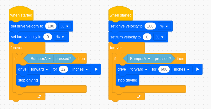

I am having my class use VEXcode V5. In this case the the drive-train is a 2-motor with 4in wheels, 11.75in track width, 7in wheel base, 1:7 ratio, with green gear cartridge.
The robot will drive and stop with the code on the left, like its supposed to. But the one on the right seriously goes for well over five minutes before I stop the program. The track I made them is 5ft or 600in.
Screenshot 2021-12-08 7.48.34 AM

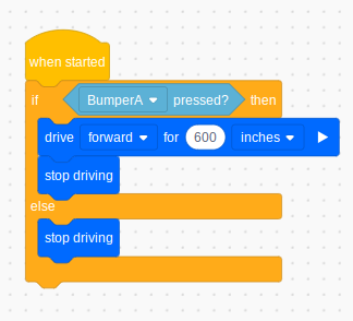

Can you try the same thing but with an else part underneath?
The if-then-else hat.
with all the other code around it
Your making it drive forward for 50ft, not 5ft
Change the varible to 60in and see is you have the same issue

Just tried it. Same thing. It basically forever when I want them to put any amount of inches over like 100. It stops when I have them put like 20" while holding up the drive-wheels when they are making sure they are going the correct direction though.
