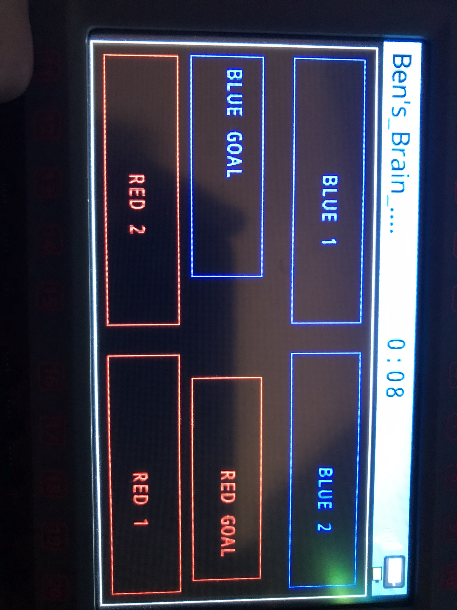

Did you want to go for an autonomous selector like this one?
Not sure if this is what he’s looking for, but do you mind sharing the method for this?
You just have to draw out 6 rectangles on the brain in the pre-autonomous section, and then program each rectangle to act as a button through if-else statements. This way, when the brain is pressed in a certain location, it will run code or draw something on the brain screen. That’s pretty much it.

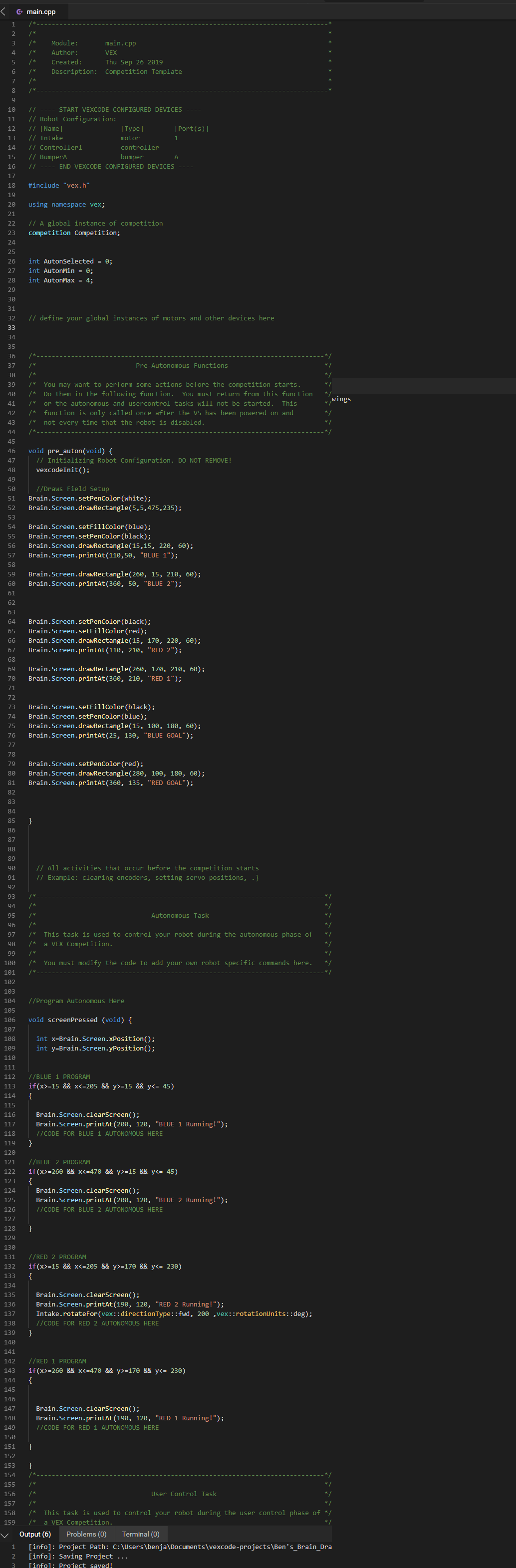

I can also show you my program if you wanted to analyze it.
I think that would be great if you could send it to me. Thank you!
Here is my program for my autonomous selector…
