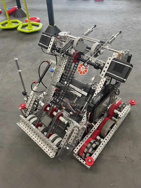

Im running hood and my bot only weighs 10.8 pounds.
Picture:
