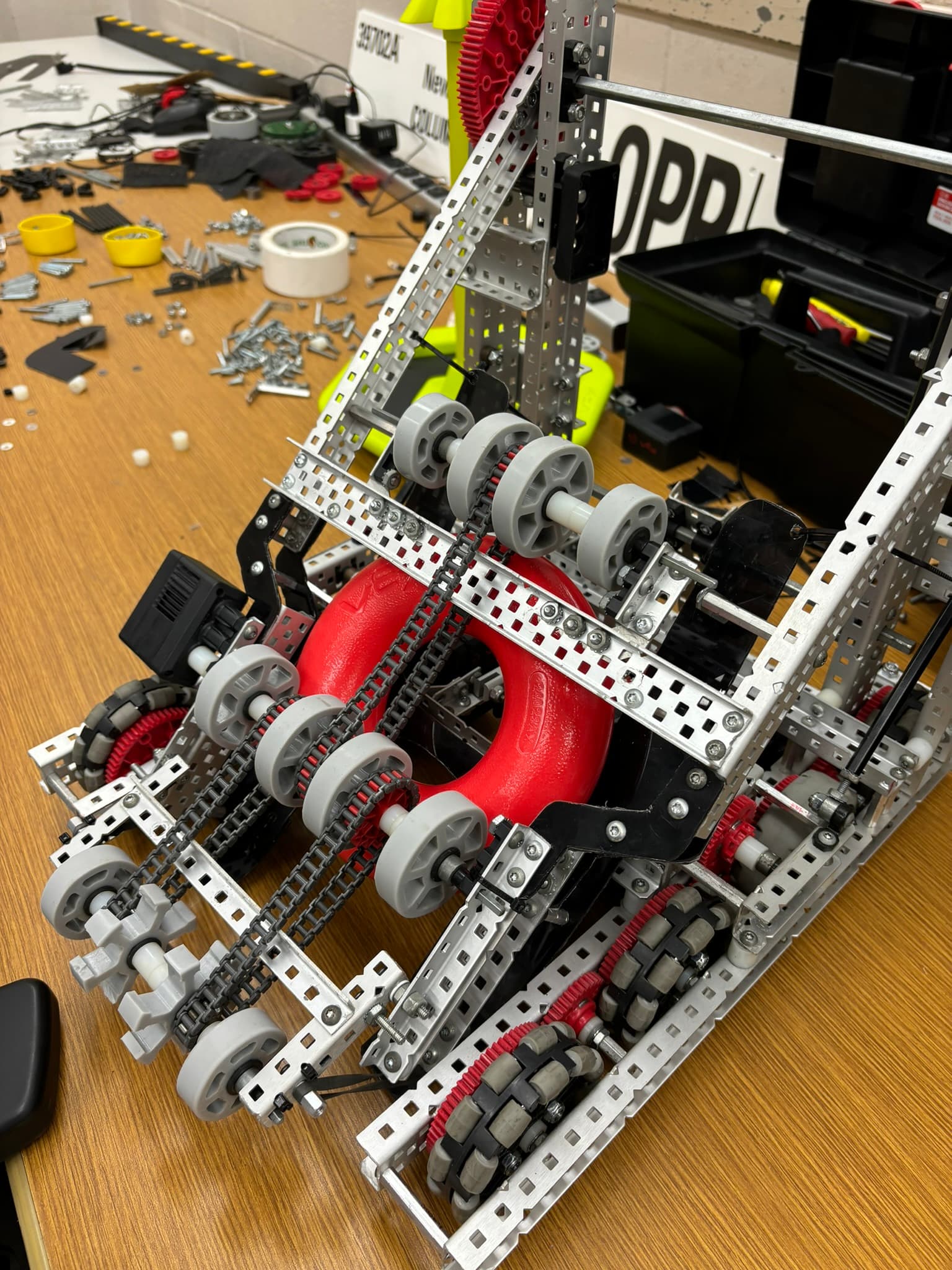

Personally I prefer the Hood type. Some others teams I’ve seen have had issues with their hook intake for example the motor would get hot so the chain would not be moving as fast, and for what I understand of hooks is that design relies on the chain speed. When the chain slowed down that caused the hook to not fling over properly. With the hood intake even if the motor gets hot it should at least keep intaking the ring just a little slower. Another thing they’ve struggled with is that the ring would fling out at the transition point or just fly off instead of falling on the goal, but the hood intake doesn’t have a transition point for rings to fly out and has better control of the ring when it exits on a goal. Here is
an example of at least half of a hood intake.
i mightve replied earlier, but we changed our design. We are actually using both intake systems, with a split in the middle that houses an automatic color sorter. we are using flex wheels for the initial part, then switching to omniwheels so that the sideways moving chain of the color sorter can still pull out the rings, then after the color sorter we switch to the hook method, which allows the rings to be put on the mobile goal with ease.
In my opinion, I think that the hood intake will be slightly better if perfectly tuned if you compare the Ex Machina 66475C robot, which uses a hood with other hooked intake robots. The ex machina one is just an example but my point is that if it is tuned well then the hood will be a lot smoother and more consistent compared to hook which can over fling if the speed of the chassis is increased or decreased suddenly.
