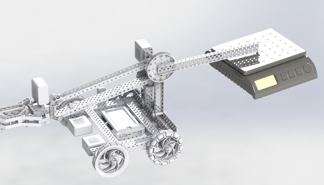

Directly measuring torque is a challenge. When I worked for La-Z-Boy, I used something like this Socket Extension, Reaction Torque Sensors for Bolt Torque to measure the torque for operating the chair handle. You might be able to work something out with a less expensive “beam” type torque wrench, like this one: https://www.amazon.com/Performance-Tool-M195-Torque-Wrench/dp/B00SNICDJC/ The potential issue you may have with using a wrench, however, is that your torque will always be the torque at the point the motor stalls. Only an in-line transducer like the one from Omega would let you measure torque while the machine is running. You could also build your own stall-torque measure device by attaching a beam of known length to the end of your shaft and measuring the force at the end of the beam with a small gram or ounce scale. Torque is just the length of the shaft tiimes the measured force on the scale.

Here’s an example test rig you could set up. Torque would be the length of the beam (from the center of the motor shaft to the point where it is pressing on the scale) multiplied by the scale readout.
τ=FSin(θ). It’s multiplied, not divided
Right…thanks for catching that. (I’ve corrected my posts). Long day, and I forgot all my arithmetic when I took Calculus, and I haven’t used Calculus for 30 years, so I’ve forgotten that too :crazy_face:
No worries : )
Yea I’m looking for the experimental values because my gear set is semi inefficient and also thanks kmmohn for the CAD picture I was confused on how the setup would be. Also is that example for how to do stall torque or for torque (sorry I’m not good at words) I’m assuming stall torque because your measuring for how much weight it can push until it cant push anymore.
Right, the set-up shown would be stall torque…or it might be the torque where your shaft starts twisting…be careful if you’re using a low strength shaft in a V5 motor!

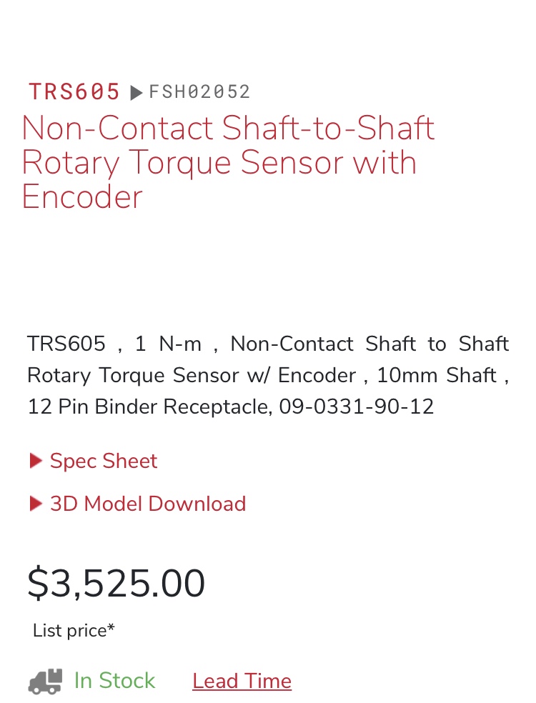

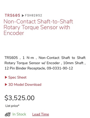

this product looks a little out of the typical vex team’s price range lol
nice try though, mr. force_measurement_sp
yes but this helpful fellow made an account just to post this super useful tool, the least we could do is buy a few dozen. if it’s 3 and a half thousand dollars it must be good!
Naw, we go in as a group buy and get one, less than a dollar per team :slight_smile: Now if just shipped in less than 6 weeks…
500 4” flex wheels would be a better investment ngl
yes, but how are you going to measure torque on those flex wheels hmmm?
use them as weights. when the string attaching them to the gears stalls u can calculate the torque
