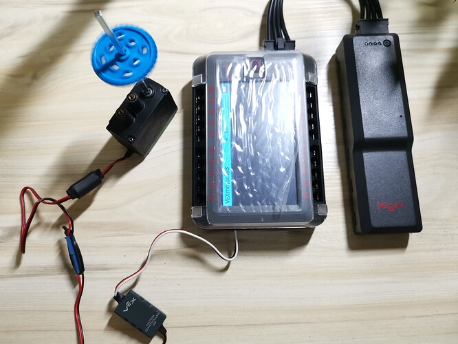

I use the 393 motor to V5 brain. It works.
1.Use the 29motor controller to connect the 393 motor
2. insert 3-wire port to V5 brain port
3. program

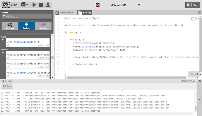

i think some people came here to see the code, so here is what i have.
vex::motor29 motor2( Brain.ThreeWirePort.A )
    while(true) {
  if(Controller.ButtonY.pressing()) {
        motor2.spin(directionType::fwd, 127, velocityUnits::pct);
    else if(Controller.ButtonA.pressing()) {
        motor2.spin(directionType::rev, 127, velocityUnits::pct);
    else {
        motor2.stop();
