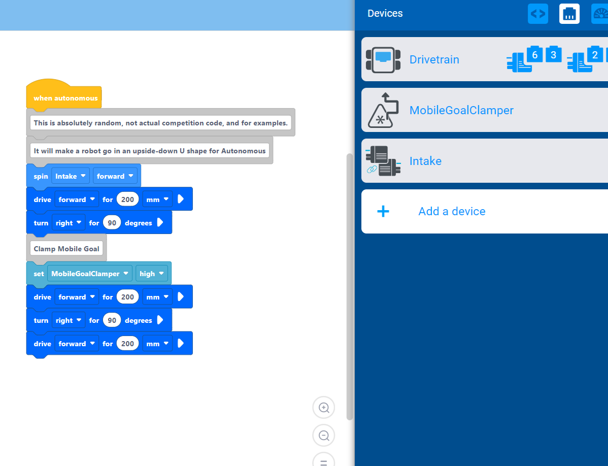

You can do autonomous using these:
For VexCode Blocks:

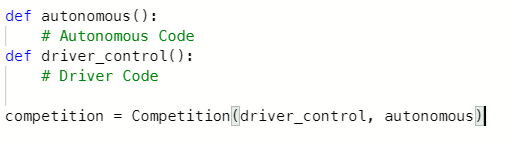

Python:

competition Competition;
void Autonomous(){
  // Autonomous Code
int main(){
  Competition.autonomous(Autonomous)

You do code that is specifically for Autonomous. For example, you could put something like a bang-bang algorithm for beginners:
Or, if you are more advanced, an Odometry and PID.
So basically, you try to score as much points as possible in advance through Autonomous movements like the image above.

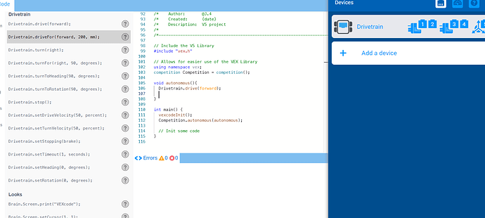

If you are talking about C++ with vexcode, which you mentioned in your first post and the previous one, you can use the functions on the left side of the screen.
All functions you’ll ever need are there or in Vex API.

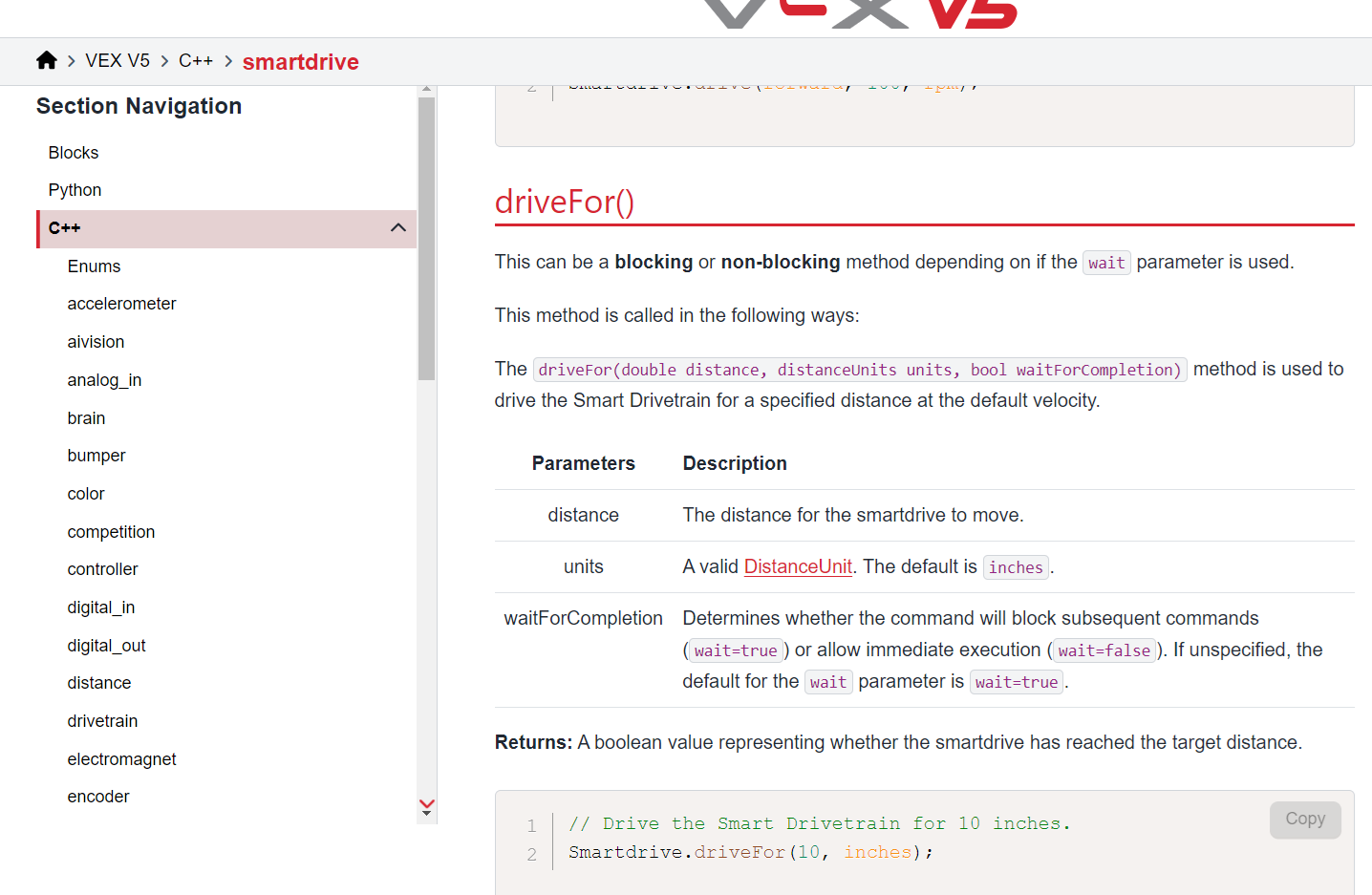

It actually does. You need to look hard enough for it. :sweat_smile:
Go to V5, C++, then Competition through the navbar and sidebar.
Autonomous is located there.
Motor, Drivetrain, Pneumatic, Vision Sensors, Timers, Sensors, LEDs, and more have functions that are all listed in there. (There are much more, I’m too lazy to list them)

Yes, that function is part of Vex API (this link directly links to it).
All VEX functions intended for student use are listed in the API.

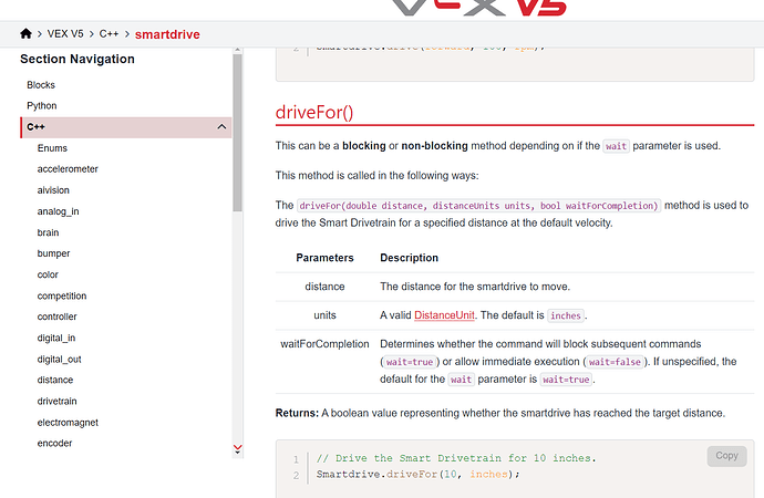

Another thing: I have an idea for what to do, I want to go forward a certain distance. How would I do that in auton mode? the website doesn’t really say anything about that… :sweat:
Think… What causes the robot to move forward? A Drivetrain (called SmartDrive in VEX), of course!
On the sidebar, “drivetrain” will show you the functions after you initialize it. All functions are under the “Class Methods” header.
After scrolling down a bit, I see this:
That means we can do this:
Drivetrain.driveFor(10, inches);
to move the drivetrain 10 inches forward.
(yes, you do need to run with Drivetrain, not Smartdrive)
