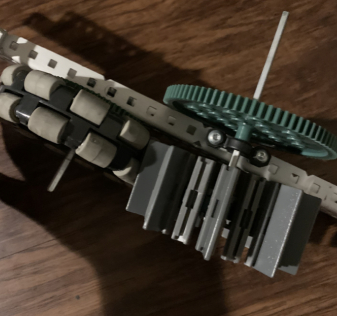

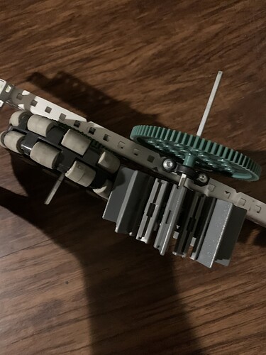

How to fit 4 inch omni and gear in 3 holes

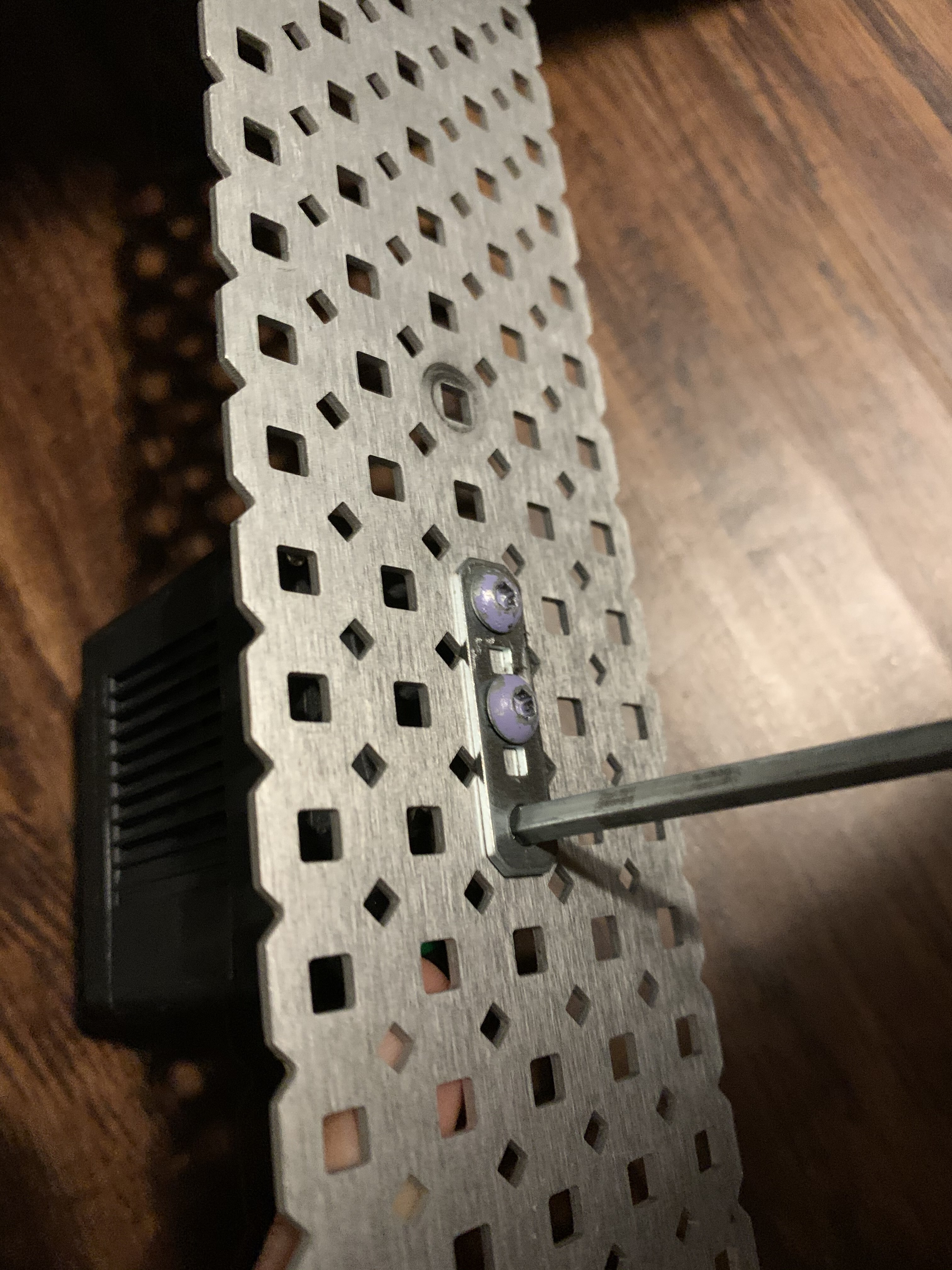

Thinner bearing flats
Also this is a good way to save space for the chassis and other things
It also has same amount of slop as a standard bearing flat so this is good

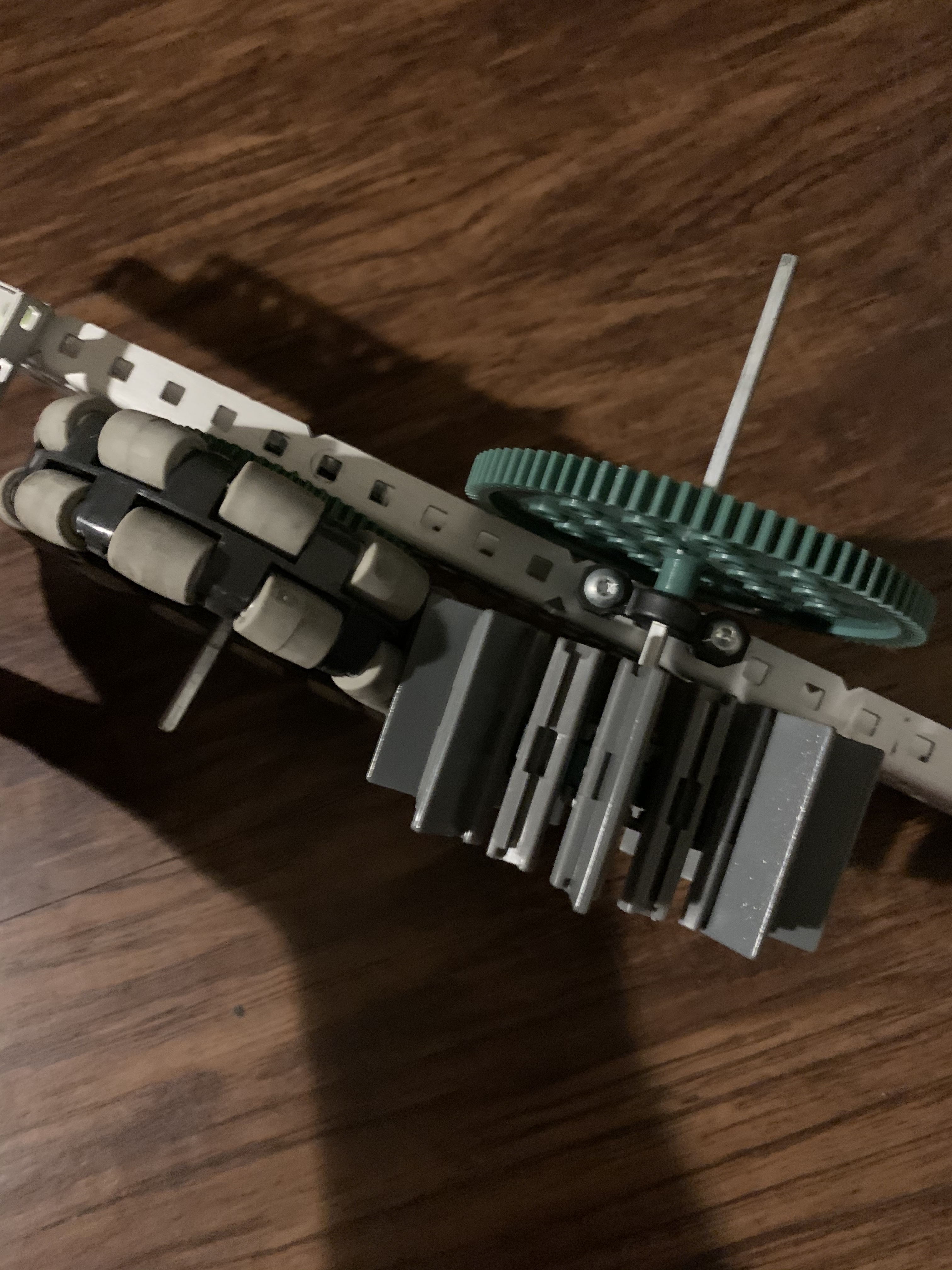

Here is a video about 4411S’s worlds robot where they have a similar base setup as your’s.
They drilled the outside c channels slightly so there will be just enough margin for the omni and gears to fit in the 1.5” space. You can also consider flipping one of the c channel and file down the spots which contacts the wheels.

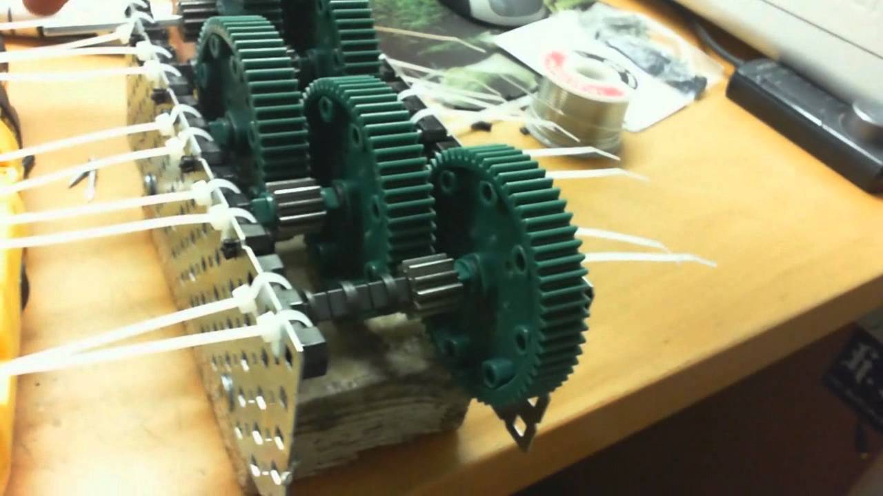

In terms of slop, you can probably just ziptie the gear and wheel together. I did this on one of my base and the result turned out to be pretty good. Standoffs also seems to be an option but I’m not really a big fan on forcing things in
