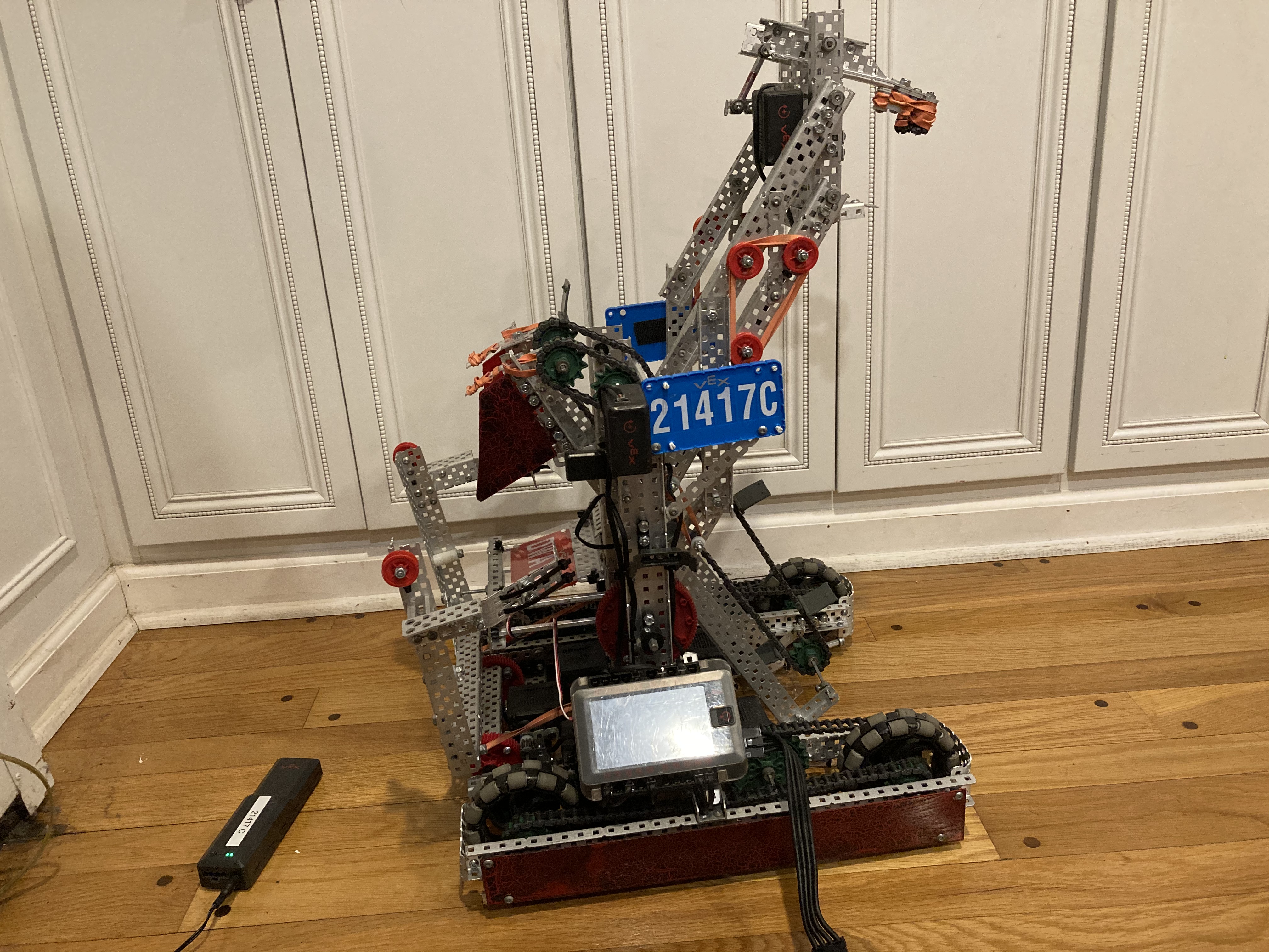

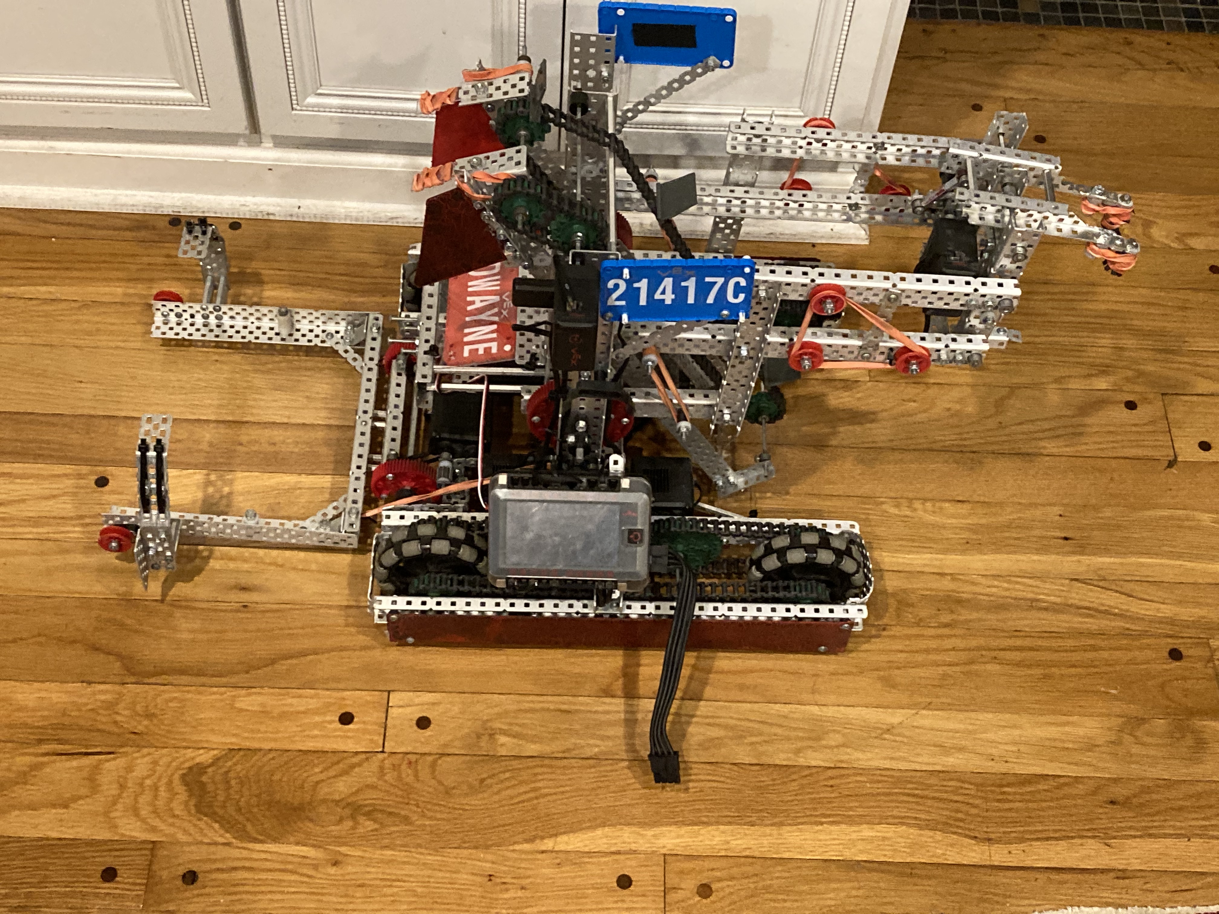

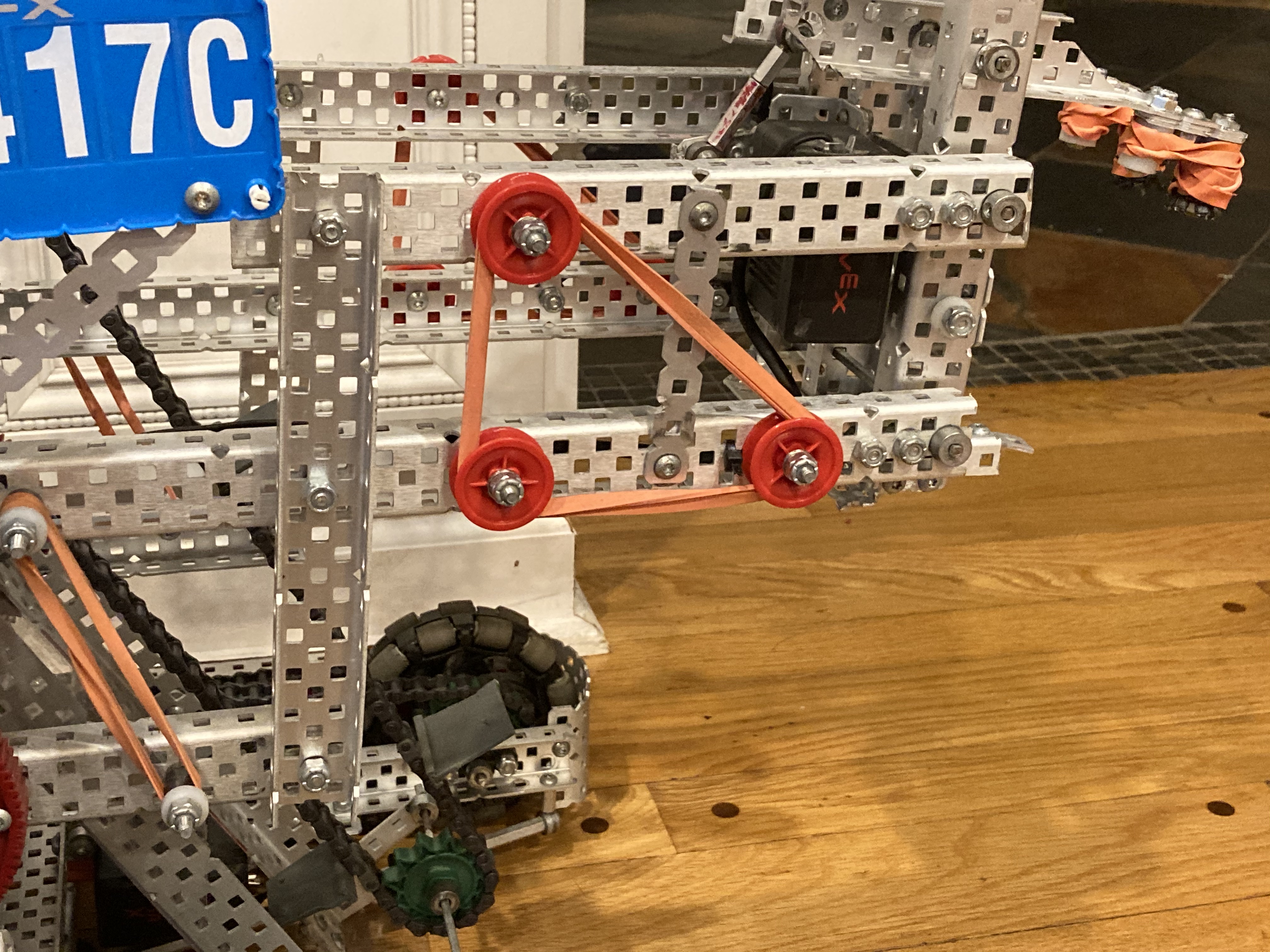

Our claw doesn’t use pneumatics. I don’t know how well you can see this, but our claw worked by one motor and had a little mechanism that was basically some standoffs and lock bars (for the shaft) that were hinged together. We also used a six bar to be able to get mobile goals to the back of the platform.
It wasn’t as strong as pneumatics, but it worked pretty well.

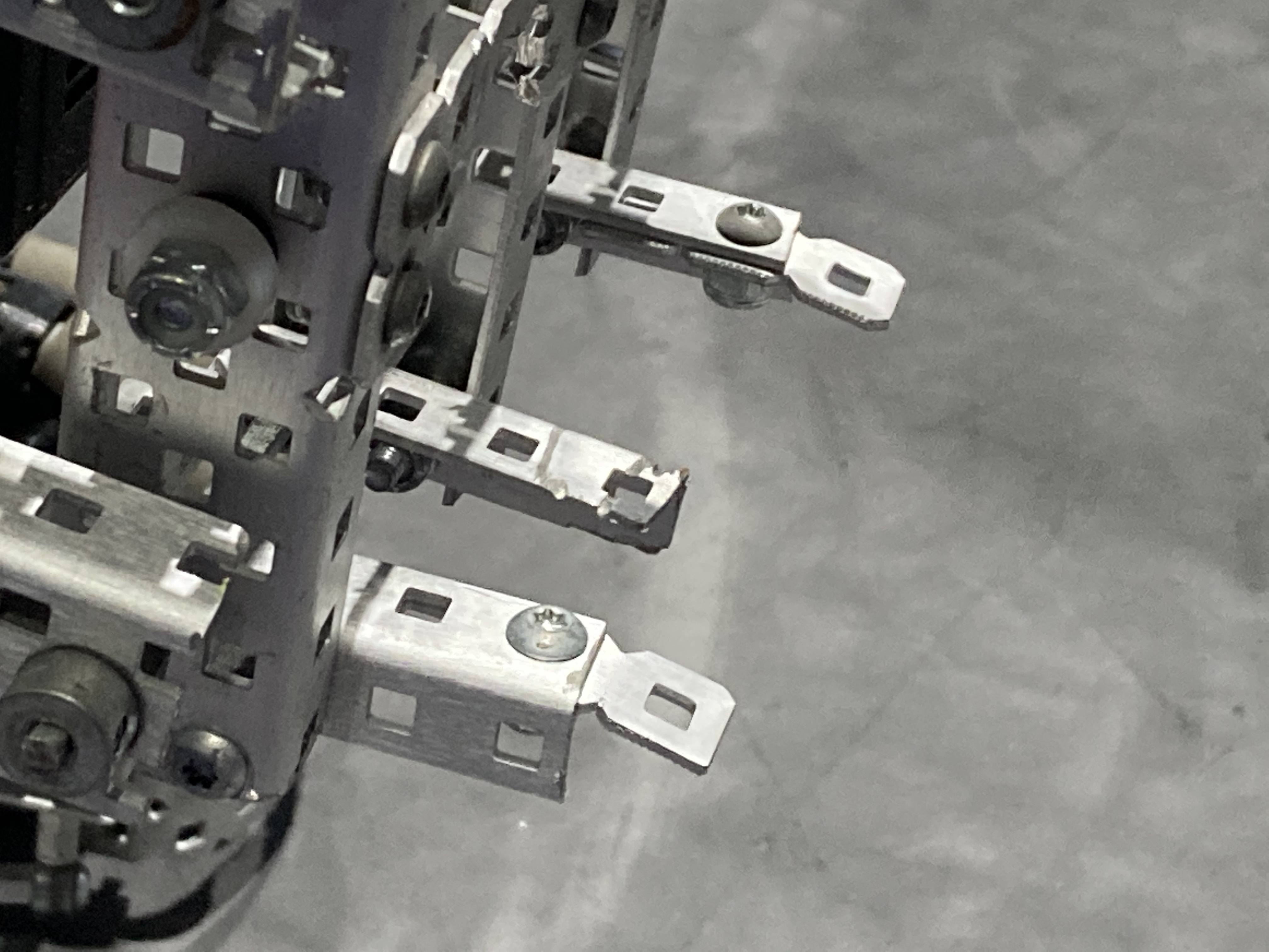

Thanks a lot this is very useful if possible can you give a closer look on the claw area?
Here are a couple. I don’t know if these are much better.
Basically, we got the idea for this claw from another Indiana team named 323V who used a similar claw at the beginning of the season.

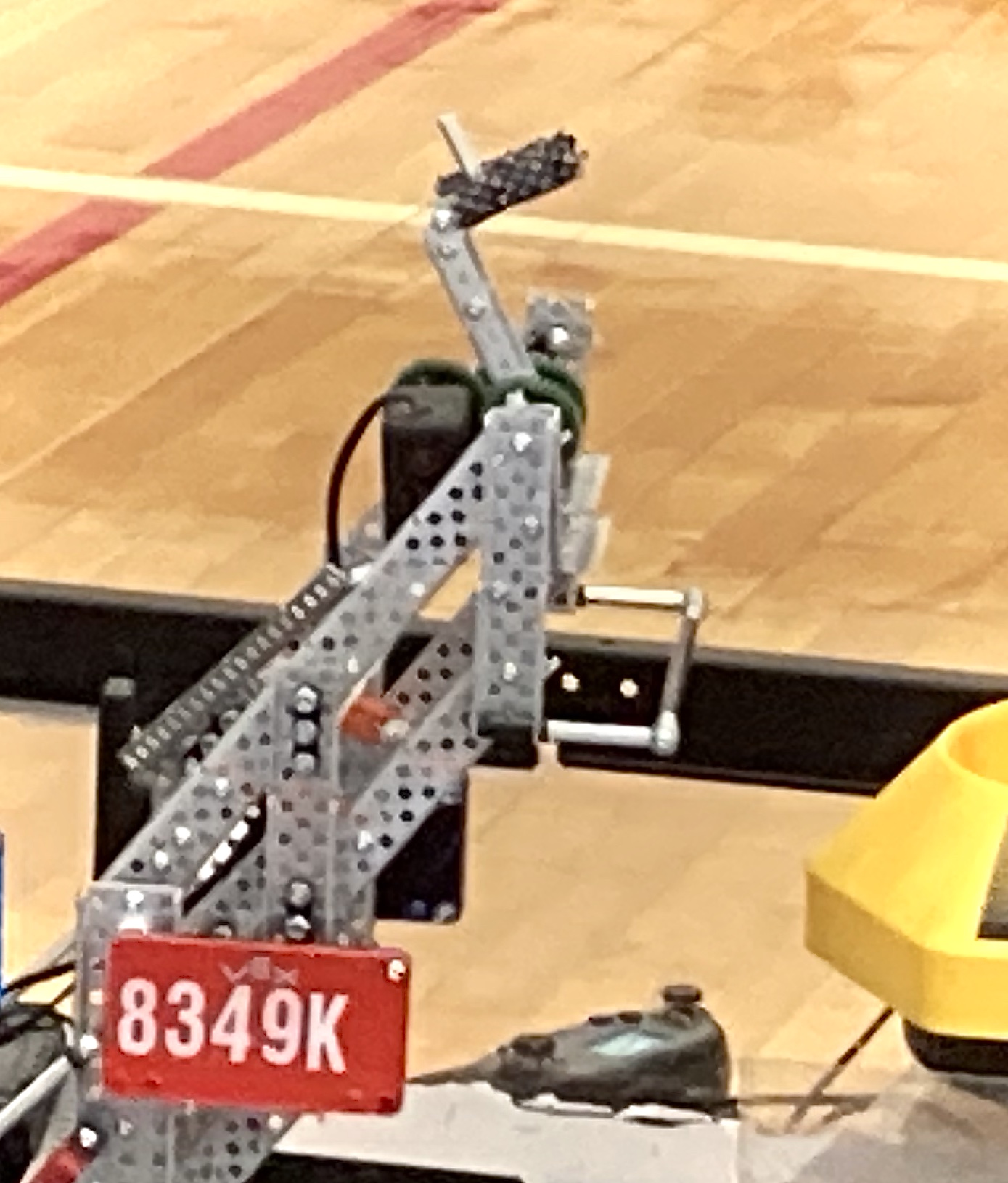

Personally, If I were to make a motor-powered claw, I would do something like DOGO from Harvard-Westlake’s reveal: Harvard-Westlake Robotics: AMOGO x DOGO Reveal. I feel like this claw, while maybe slightly slower, would be much more easy to approach and grab a goal, and maybe a little stronger.
8349K? never heard of them
