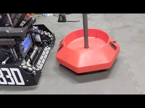

But, given the current status of my robot, I want to be able to hold 2 goals, stack one of them with the 4-bar, and score rings on the other.
You could try this if you have the space
I have seen people use similar systems for holding the MOGO to be scored on
Thanks for the video, this looks pretty similar to my robot’s case.
