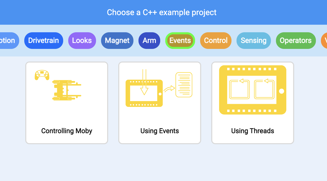

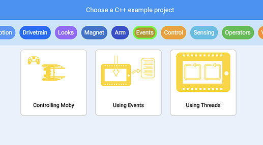

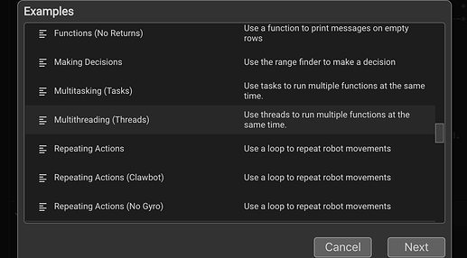

I was looking at the VEXcode Pro V5 vex::thread documentation ( VEX Help (vexcode.cloud)), but I don’t really understand how to make a thread and make it run code.
VEXcode has examples showing how to use threads, have a look at those and then ask questions if you still don’t understand.
I couldn’t find the examples, but I found a forum thread that answered it: One Thing Runs But Everything Else Stops - Programming Support / VEXcode Pro V5 Text Tech Support - VEX Forum
ok, you really don’t need to worry about the whole detach() function.
example is here for VEXcode.
or here for pro
