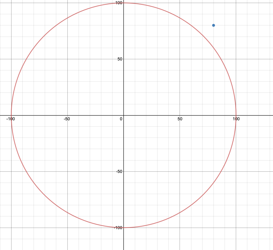

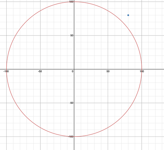

K so I ran some numbers and to hit 80, 80 at 45 degrees the circle would require a radius of 113. But that means that the maximum value of a v5 controller would be greater than 100. Have you tried graphing all the values? Like around the entire circle?
Here is a quick graph that I just made the point showed is 80,80

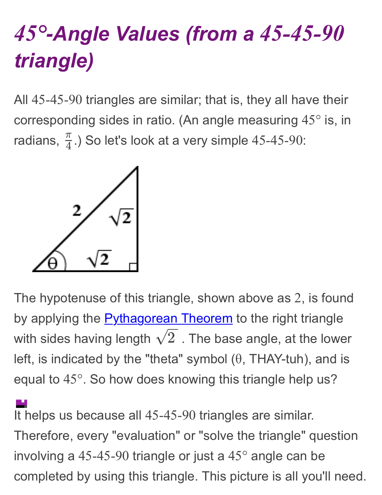

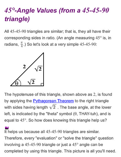

If its properly read at a 45 degree angle fully stressed, you would use a 45 degree unit triangle to figure out why that happens:
(1/sqrt(2)) * 100 = roughly 70
Using this image as reference
