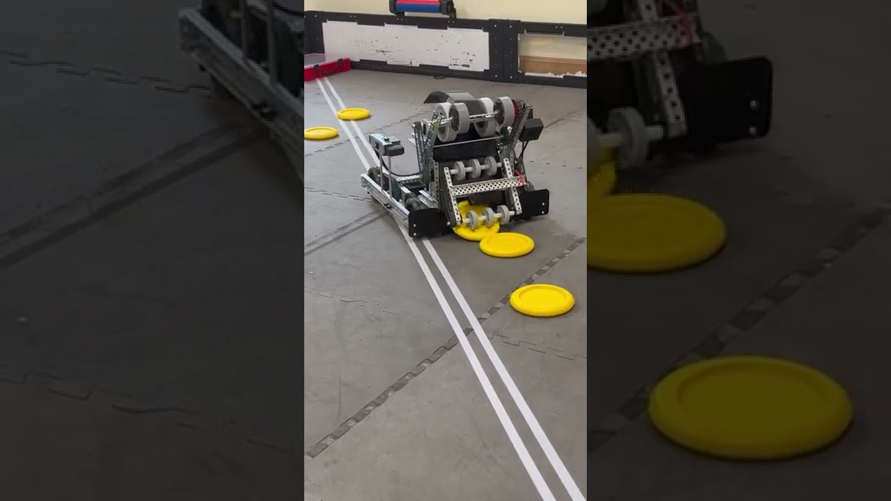

So we have a normal robot base and we kind of want a flywheel launcher type of base but without a flywheel.
IMG_20221104_085702
You want a feeder that is seen on flywheel type launchers?
Well these intakes are seen all over YouTube
Just search it up on YouTube
Also no one is gonna outright give you a design to copy or follow, you gotta do this part on your own
thanks, but our school cannot afford any more of those pieces
PS, those flywheels are called flex wheels. That might clear up some confusion.
But the key thing is 1/2 into the post Jon flings out a number of different ideas on what to do / use from parts that you may have.
The X in VEX is being able to frankenmash parts together to make a new part.
If you can’t afford those pieces, use gears with rubber bands wrapped along the circumference. Works really well suprisingly. Unsure if bigger or smaller gears work better but smaller definitely worked for us (36 tooth instead of 60 or 84). all the parts you probably have.
