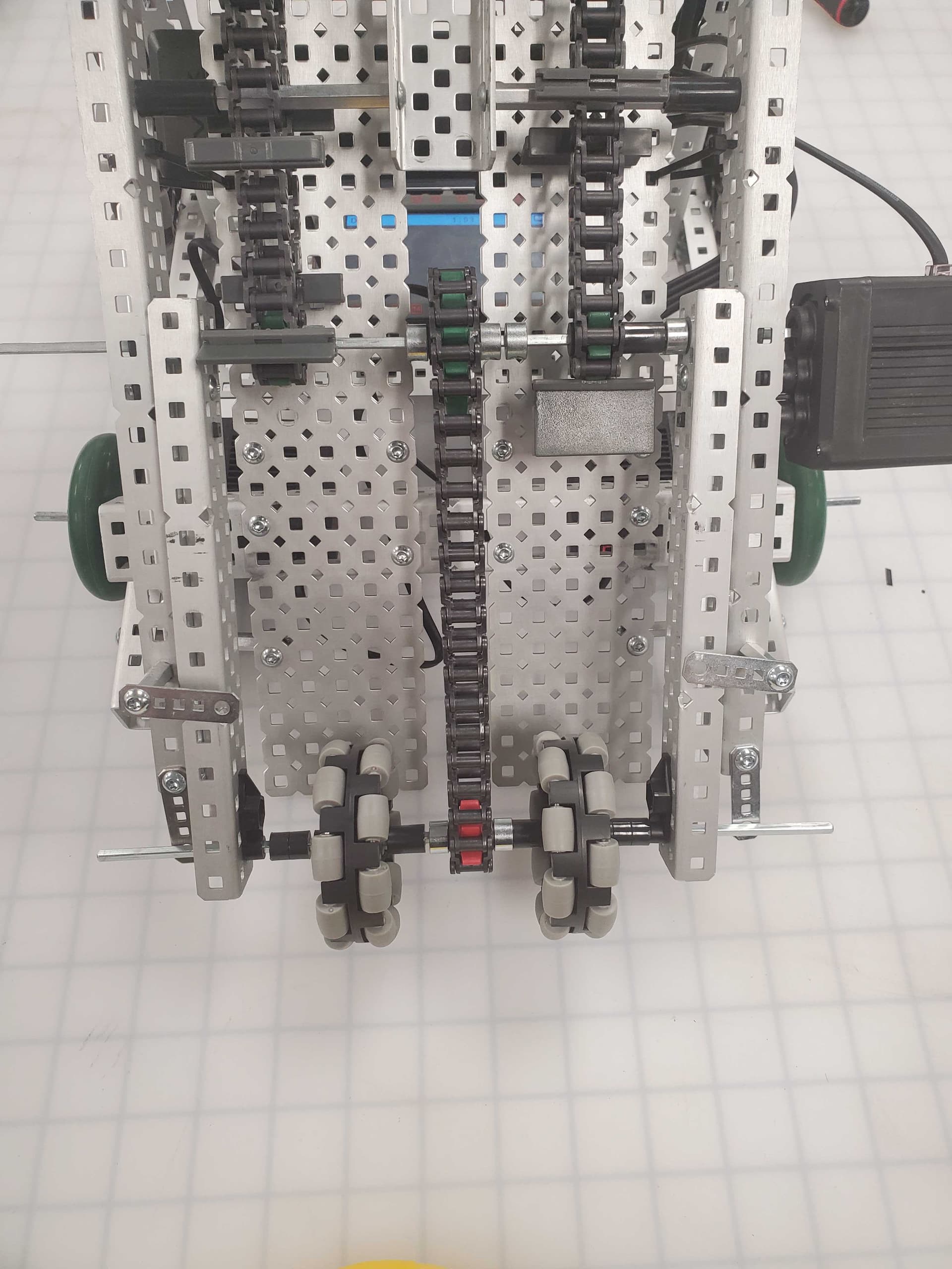

*******Omni-Directional Wheel Intake
This uses (2x) 2.75" Omni-Directional Wheels to replace the front roller on Disco.
Note: The rubber rollers can collect dirt. To keep the performance of this kind of intake consistent, VEX Engineering recommends cleaning the rollers regularly with water or WD40.

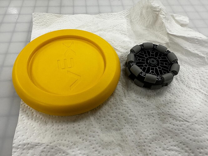

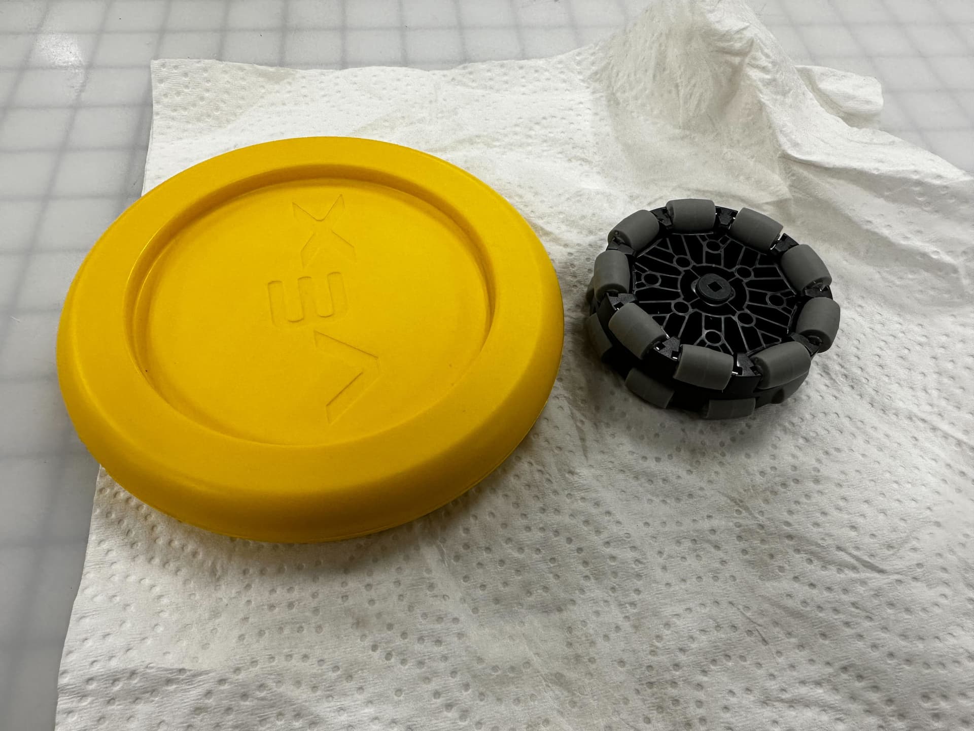

I do have strong concerns about this recommendation though:
Using WD40 in this manner from my understanding will violate R7b in 3 separate ways. R7b states (with emphasis added):
Any non-aerosol-based grease or lubricating compound, when used in extreme moderation on surfaces and locations that do NOT contact the playing field walls, foam field surface, Discs, or other Robots.
  1. WD40 is generally (but not always) aerosol-based
  2. It would be very difficult to spray WD40 with “extreme moderation”
  3. The rollers mentioned in the OP by definition touch the discs, and after doing this would spread WD40 residue onto them.
Yes, the quote says to clean the rollers with WD40, but
  1. WD40 residue will remain, especially in the relatively porous rubber
  2. The WD40 will seep in and lubricate the roller joints.
Good points. If you do use WD40 to clean the rollers, you will need to thoroughly clean the wheels before using them again. Here’s an example of an omni that was cleaned with WD40 and then used to intake the disc shown.
Thoroughly clean means wiping off an excess WD40, blowing any remaining WD40 out, repeat.
If you have suggestions for other topics/insights you’d like to see, let us know and we’ll see what we can do.
Sure, you can wipe the WD40 off the external surfaces, but how are you going to get it out of the roller axle joint? As a ref, you’re asking me to somehow tell the difference between a student spraying a can of WD40 on their robot for “cleaning” and doing so for lubrication in violation of R7b. Expecting students to perfectly wipe off all traces of illegal lubricant before each match is only going to result in field tiles and discs ending up with WD40 stains on them IMO.
From my experience, WD-40 tends to evaporate within a few hours. This is one reason why it’s arguably a better cleaner than a lubricant.
Yep, I clean all sorts of stuff with WD-40, clean it off and then use a lubricant afterwards. WD-40 is great for softening up the junk on a part.
