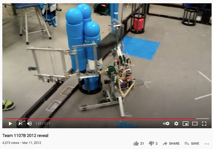

Now it’s all good to theorize about the maximum points from one goal, but is it possible to build a robot that can cram 15 balls into one goal? I say it is.
it will be a very daunting challenge though. your robot needs to be able to field, descore (many balls are tied up in goals around the field), score 3 balls into the center goal, as well as pin 12 balls to the outside of the center goal, 3 on each side.
But, I think it is definitely possible to design a robot that can do this in 2 minutes.
drive speed doesn’t matter as much, nor does drive torque, so 4m drive isn’t necessary. Side rollers are still pretty important because you need to descore a lot of balls that are tied up in goals. You do need to score 3 balls inside the center goal. And you’re going to need some way to hold 3 balls against the center goal on all 4 sides, that’s going to necessitate some crazy expansion there.
One possible robot I can think of is actually a tetherbot. if you make 2 tetherbots then each bot only has to hold 6 balls against the goal on two sides. that way no mechanisms have to wrap around the goal. and one of these tetherbots needs to be able to score in the center goal, but not both.
