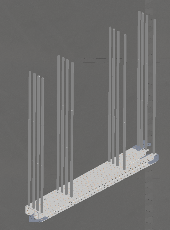

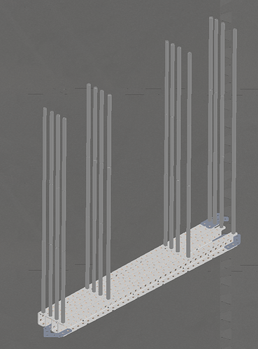

Those are good points, and I agree that it would be difficult to carry a cage to collect 12 balls and then deploy them all at once. Plus the risk of not having alliance partners compatible with your strategy…
So, the next logical step would be to deploy cage first and then use slightly modified snailbot to collect the balls and fill that cage along with the central goal.
I was wondering if any of the teams out there are developing designs that keep as much of the standard snailbot functionality, while adding ability to deploy cage(s) with the minimum dedicated (motor) resources.
For example, let say you build a standard snailbot using 7.5 motors and use remaining motor capacity to deploy two folded standalone 6-ball capacity cage modules. Then fill them with balls like you would do with the regular goals and gently forklift them into the final position next to the center goal where the balls are considered scored.
Depending on who you are playing with or against in qualifications, you may not even need to carry those cage modules into the game and could simply play a standard snailbot strategy.

true, but if you can score 15 balls in the center and quadruple it, that will yield more net points for your alliance than playing the game like a normal hood would, regardless of partner. this is both because of the massive point total you get from even just 15 balls quadrupled, and the row blocking nature that denies your opponent half their rows.
the only compatibility your partner needs to have with your design is that they have to be touching the center goal at the end of the match. as long as they do that, playing this strategy solo is still better than playing like a good hoodbot solo.
Even with a normal partner, you should be able to get to 18 and quadrupled.

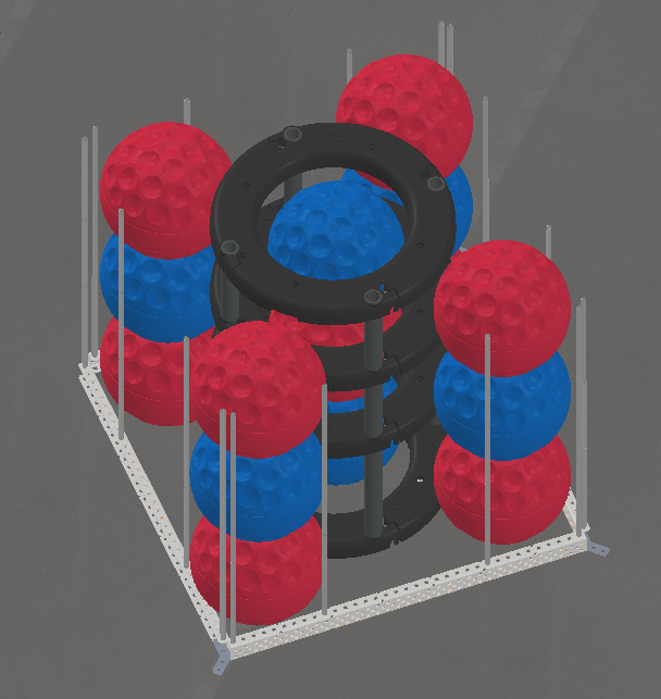

Here is another scenario. Please, tell me if my numbers make sense.
If your opponents take control and quadruple the central goal then they could score: 30 blue * 2 * 4 => 240 and 30 red * 1 => 15 for the total of 270.
Let say your alliance could score and quadruple 24 balls into a corner goal: 24 red * 2 * 4 => 192, remaining 6 red * 2 => 12, all 30 blue * 1 => 30, and take bonus for 4 rows * 13 => 52 for the total of 286 points.
That is going to be winning score unless your opponents could break two of your rows or if both of them could add a fifth stack of the 3 red balls to their central goal for the grand total of 288, which is actually impossible to beat - only to tie.
So the best (but maybe not the easiest) winning strategy is to have five * 3 ball stack capacity around the central goal.
The next best (and perhaps easier) strategy is to have a cage of three * 3 ball stacks for the corner goal and a fast tethered snailbot to maintain ownership of at least 3 rows around the field.

There aren’t actually 30 red balls available to the blue alliance here, since you only have 14 balls of the opposite color on the field per alliance.
so the real score here would be 268, assuming you own no rows and didn’t win autonomous.
again, the red alliance here only has access to 28 total blue balls, so the score here would be 284.
Still, you would be correct to assume this strategy would beat the center goal strategy. This is a way for a cage bot alliance to counter another cage bot alliance, but as far as the cage bot vs hood bot matchup goes, you’re better off sticking with the center goal strategy because if you go for a corner goal, you’re allowing your opponents to potentially take 5 rows, and you’d have trouble stopping them since you’ve just spent almost all your colored balls on the edge goals.
So basically, a cage bot alliance should always use the center goal overloading strategy against a hoodbot alliance because they will always win.
