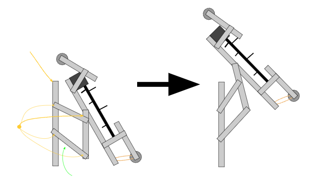

We’re thinking about a 6 motor, 360rpm drivetrain with 3 sets of omni wheels and 1 set of traction wheels close to the middle just so we don’t get bullied as hard
we’re taking a lot of inspiration from the 1 week robot that’s been being shared around a lot recently in terms of intake and mobile goal holder, but we’re strongly considering putting the entire ramp on a bar lift or something similar to lift it high enough to score on stationary goals.
Tl;Dr
Drivetrain: 6 blue motors, 360 rpm, 6 Omni wheels, 2 traction wheels
Intake / Scoring mech: Same as one week bot, but on a bar lift (see pic)
