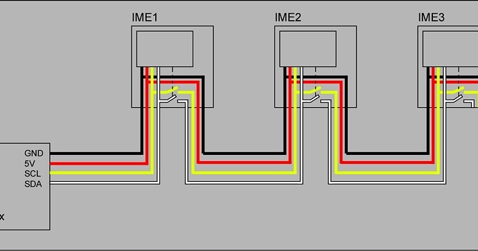

The integrated motor encoder uses a very different connection method to the other VEX sensors that is known as Inter Integrated Circuit or I2C. Phillips invented this interface in the early 1980s as a low cost means of extending the IO capabilities of the simple microprocessors being used in consumer products at that time. The I2C bus uses synchronous serial communication with only two wires, a clock generated by the host (or master) device is used to control the transfer of bits on a data line either to or from a slave device. The two wires are typically called SCL for the clock and SDA for the data. In the four wire cables supplied by VEX, the clock is on the yellow wire and data on the white wire. The other two wires, red and black, supply power to the IME with the black wire also acting as the common ground reference for the system.

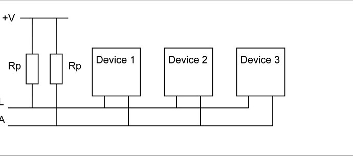

The I2C master always initiates a transaction, in our case this is the cortex, every slave device needs a unique address (think of the address of you house) so the master can talk to it. In many designs these addresses are fixed or set by configuration pins on the particular device, however, as I will explain later it works a little differently with the IMEs.

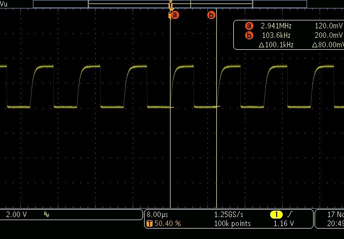

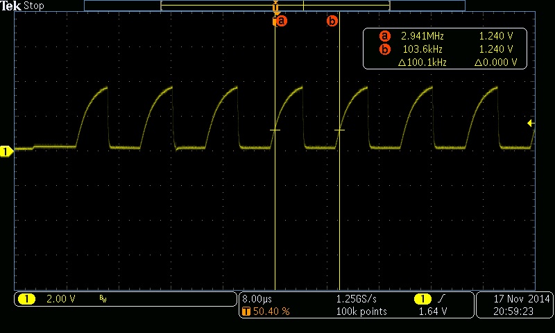

To allow bi-directional data transfer SCL and SDA are driven by open-drain drivers. The wires are pulled high (to the positive voltage) by using resistors, the master or slave device can only pull the wire low (to 0 volts). A typical I2C bus looks like this.

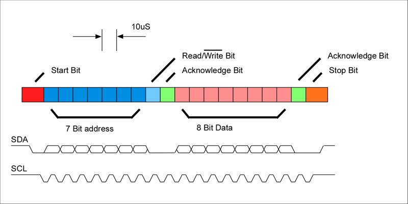

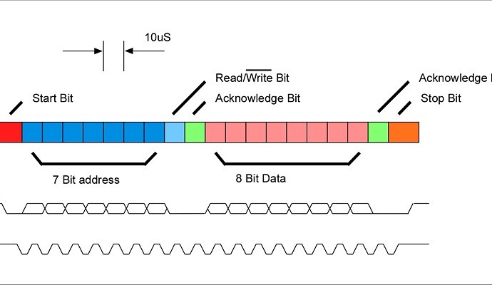

Data is transferred in 8 bit units called bytes, a data bit is placed on the SDA wire and the clock wire pulsed. A data bit should only change when the SCL wire is low, if SCL is high then the change on the SDA wire has a special meaning. If it changes from high to low this is called a START bit, if it changes from low to high this is called a STOP bit. Only the master device (the cortex) should create start or stop bits as they signify the start and end of a message.
So how does the master communicate with the slave? A typical sequence to send one byte to a slave would be as follows.
The master sends a START bit
The master sends the address of the slave it wishes to communicate with (normally 7 bits but it can be 10)
The master sends 1 bit indicating if data will be transferred to or from the slave.
The slave acknowledges it is ready by pulling SDA low for one clock cycle
The master sends the data byte 1 bit at a time starting with the msb (most significant bit)
The slave acknowledges it has received the data by pulling SDA low for one clock cycle.
The master sends a STOP bit.
IMEs differ from most I2C devices because the number of devices on the bus can be different for each robot. A technique called dynamic addressing is used, when IMEs are first powered on they all have the same address, the bus master (the cortex) learns how many devices are connected and assigns a new address to each one it finds before normal communication is started. Because each device has the same address when first powered on, there also needs to be a method of communicating with each IME so the new address can be assigned, this is done by disconnecting the SCL and SDA wires from the I2C bus for all but the IME nearest to the cortex. After a new address has been assigned that IME allows the next IME in the chain to be connected. Here is a high level diagram showing connections, note that the yellow (SCL) and white (SDA) wires are switched inside each IME.
Initially each IME has an address of 0x60 (“0x” signifies a hexadecimal number), after the IME chain is initialized they will typically have addresses starting at 0x20 and incrementing by 2 (0x20, 0x22, 0x24 etc.). Once initialized, a message can be sent to each IME in turn asking for the current number of encoder pulses it has counted. A typical message would send one data byte from the cortex to the IME indicating what information is required followed by the cortex reading a number of data bytes. Using an oscilloscope a single message can be captured and looks like this.

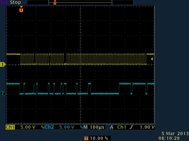

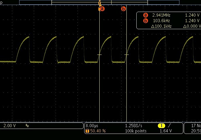

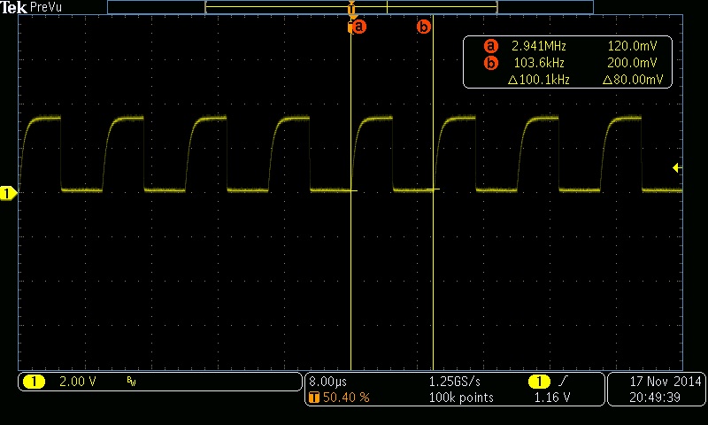

The yellow trace is the SCL wire, the blue trace is the SDA wire. This message was reading 6 bytes of data from the IME at address 0x20. A close up look at the beginning of this transaction is as follows.
I have added annotations to this capture as well as vertical lines showing where the SCL wire is changing from low to high, this is where bits on the SDA wire are valid. The transaction starts out with a START bit (indicated by the red S) followed by the address 0x20 and a write transaction bit. The slave responds with an acknowledge bit where it holds the SDA line low (indicated by the green A). The master sends one data byte, 0x40, without going into details this means it wants to read the encoder count. The master now sends another START bit (known as a repeated start, this avoids having to send STOP followed by START) followed by the IMEs address again, it then reads 6 data bytes from the IME. As the master receives each data byte it acknowledges all except the last one where a not-acknowledge is used to indicate that all data has been received. Finally the master sends a STOP bit.

One area I had neglected to look into when I originally wrote this description was the circuit used for the switch in each IME. When the IMEs are first powered, they all have the same address as I explained in the post #1. So that only one IME answers this address each IME has a means of disabling the I2C bus to the next IME in the daisy chain. I had assumed this would be an I2C bus repeater, something like the NXP PCA9515, it turns out to be a dual channel SPST analog switch from Texas Instruments. I was surprised at this choice due to the 10Ω series resistance, not the end of the world but there are parts with much lower Ron. Probably a choice dictated by cost or some other factor I’m not aware of, I never actually got around to reverse engineering the IME schematic.

Here is a scope capture showing the I2C clock when only one IME is being used.
[ATTACH]8733[/ATTACH]
The rising edge of the clock looks good, how fast the clock rises is determined by bus capacitance and resistance.
Here is a scope capture of the I2C clock (at the cortex output) when 6 IMEs are daisy chained together.
[ATTACH]8734[/ATTACH]
Notice how the rising edge of the clock is now much slower (The same effect is also happening to the data line but the clock is easier to capture).
The I2C spec says that in standard I2C mode (that is 100KHz clock which ROBOTC, EasyC and ConVEX all use) the SDA and SCL lines should have a maximum rise time of 1uS. This second scope trace shows that with 6 IMEs we are pushing the limit on this spec. The addition of two further IMEs will slow the transitions even further and I suspect was the limiting factor in how many IMEs can be added to the chain.
Now having explained the above, it may just have been that 8 seemed like a reasonable number that no one would exceed in normal use :slight_smile:
