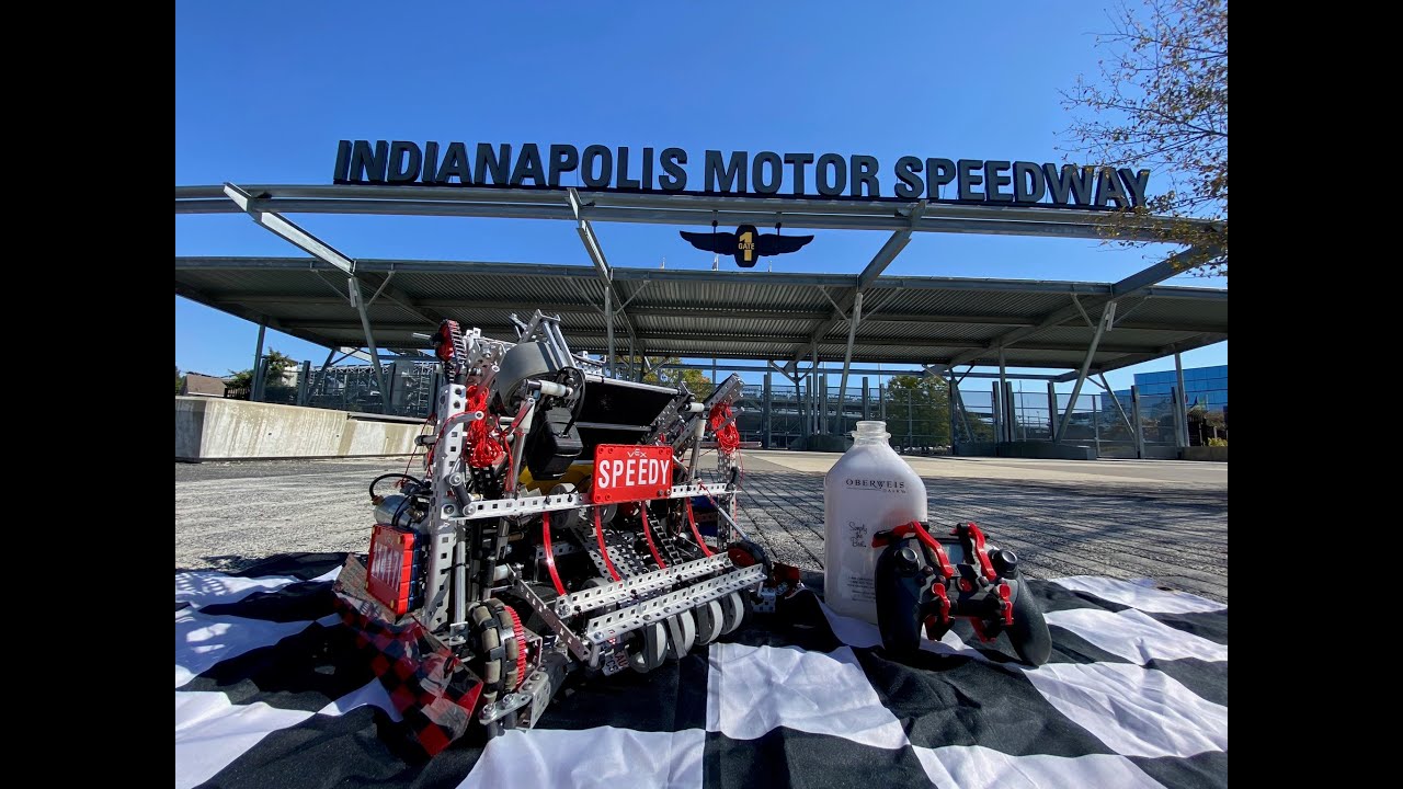

Using a 2 motor flywheel will improve your rate of fire as it reduces your rpm drop. With your motor distribution, I would recommend connecting your intake and roller using sprocket and chain which frees up an extra motor for the flywheel. A good example of this motor distribution is MENTORBUILT
