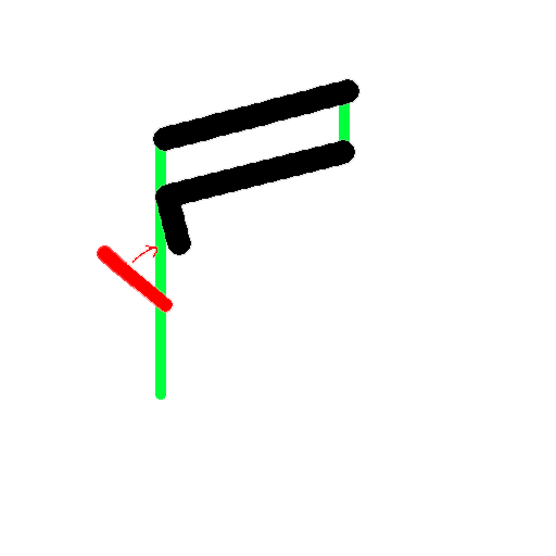

One of the first things that comes to mind for a system like this are slip gear driven mechanisms like catapults or punchers. They are moved slowly and with plenty of torque one way, and very fast passively (with no motors) the other way. For this particular design, gravity would suffice in place of ribber bands, although I’m not sure how you would make the slip gear without illegally modifying IQ parts. As for a transmission, not sure how you would go about implementing one. However, the risers don’t seem to be very heavy ,and you really only need to lift two, as you can keep the third one on the ground. With a two motor lift you could probably get pretty good speed and not have much of a problem with torque. I do really like the general concept and I think it could give you a nice competitive edge.
Here’s an illustration of what I meant by a slip gear kind of concept:
Explanation
Green = Towers.
Black = 4-bar lift. This could obviously be modified for any type of lift.
Red = motorized bar. It would spin against the perpendicular part of the lower black bar until it reached a certain angle, at which point the 4-bar would fall back down.
