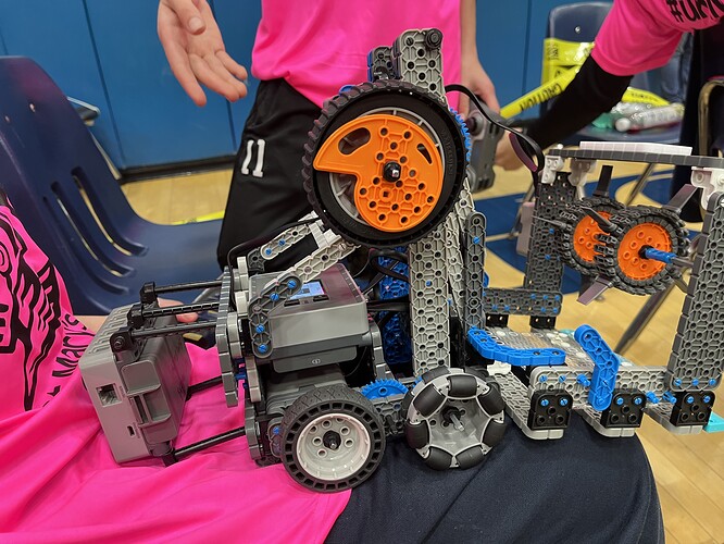

Is this even legal to do?
While we were at our compitition, we saw a robot with two brains and 2 battery packs on their robot using one as a weight? Is this even legal? Photo below

This is not legal per R11, which specifies that robots are limited to 1 robot brain.
It is arguably also covered by R1, insofar as teams can only have one of subsystem two (including max. one brain/IQ control system).
@Vex2024, did robot inspection take place at this event?
That said, the inspection checklist (https://recf.org/documents/2023/05/robot-inspection-checklist-viqrc-full-volume.pdf/) does not make it immediately obvious that a robot can only have one brain. If there is an inspector without much knowledge of the rules themselves beyond the checklist (perhaps a parent) then it could have easily slipped past. It is clearer, however, that the robot can only have one battery pack.

This sounds more like check-in then any substantial inspection. What is being inspected from your first and last name? It does not seem that R3 (robots must pass inspection) has been followed.
By no means should a team have won an award for a robot that was illegal. It is not even a robot according to the manual’s definition (“Robot – A machine that has passed inspection…”).

This may a gray area - the second brain is not a functional element but purely used as weight. As you can see no wires are connected nor it seems powered up. So I’m not sure it violates a rule……
If it’s used as weight, it is functional.
The function is weight. There is no grey area here, the team is in violation of R11 and should not have passed inspection.
This is not gray at all, it is clearly against <R11> and <R13>.

90% sure this violates the rule of only 1 VEXIQ brain and 1 VEXIQ battery on the robot. the only argument for it could be that its non-functional, but its quite interesting if It passed inspection, seeing as I’m fairly certain that its part of the inspection checklist that a robot only has 1 battery place and one brain

Ah but see, the function is the weight! So even that argument is invalid.

Sorry I meant non-functional as a brain
