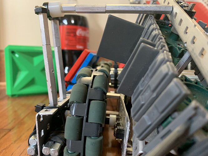

I don’t have arms because I have a simple tray, but no, It doesn’t move on a hinge, It is on stand-offs that just get pushed out when the tray moves forward. right now I’m rebuilding my robot so it’s less jank but here is a pic of my jank early season intake (please note a lot of the robot is recycled from Turning Point and In The Zone).

Just out of curiosity, why are the high-strength axles zip-tied to the frame of your robot?
Those were counterweights that I used because that was a very jank early season bot with a recycled chassis and it tipped back even with an anti tip making auton a little inconsistent.
