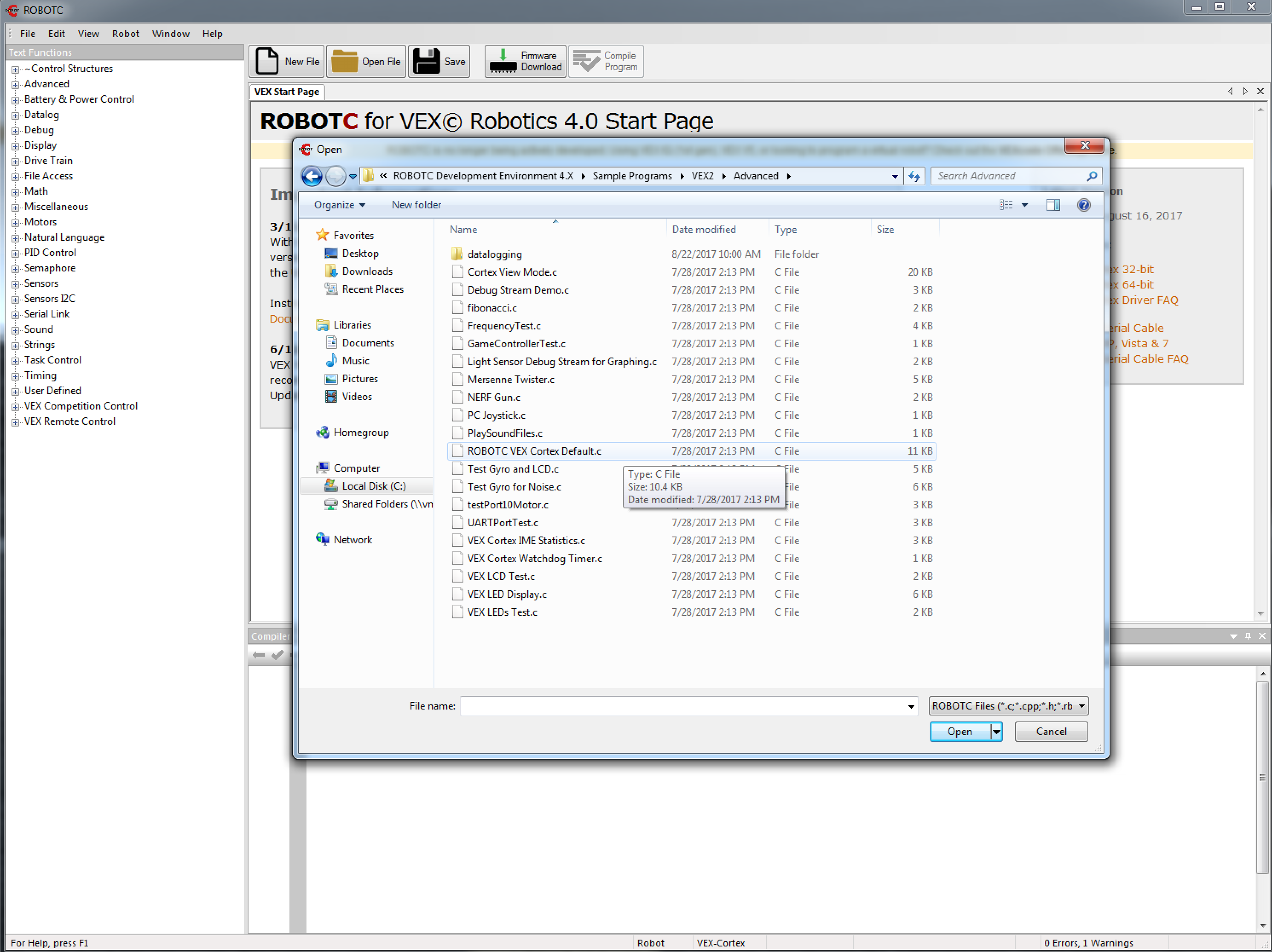

I assume these are cortex brains and not the even older pic systems.
The “default” code provided by VEX can be downloaded by the old cortex firmware utility, however, RobotC includes as a sample program that is a close approximation of that default code. here it is if you cannot find it.
ROBOTC VEX Cortex Default.c

That is correct. I have the Robot C installed but I have no idea where it may have stored teh Sample Code. Now,… How do i download what you posted from this site?
FYI,
I just did a cut and paste via the copy icon in the upper right corner, into notepad and save as Defualt.C
That seems to work

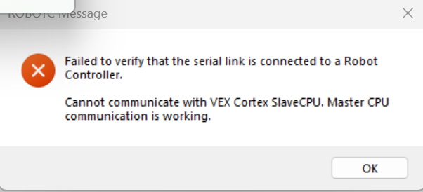

This is the actual error I am seeing.

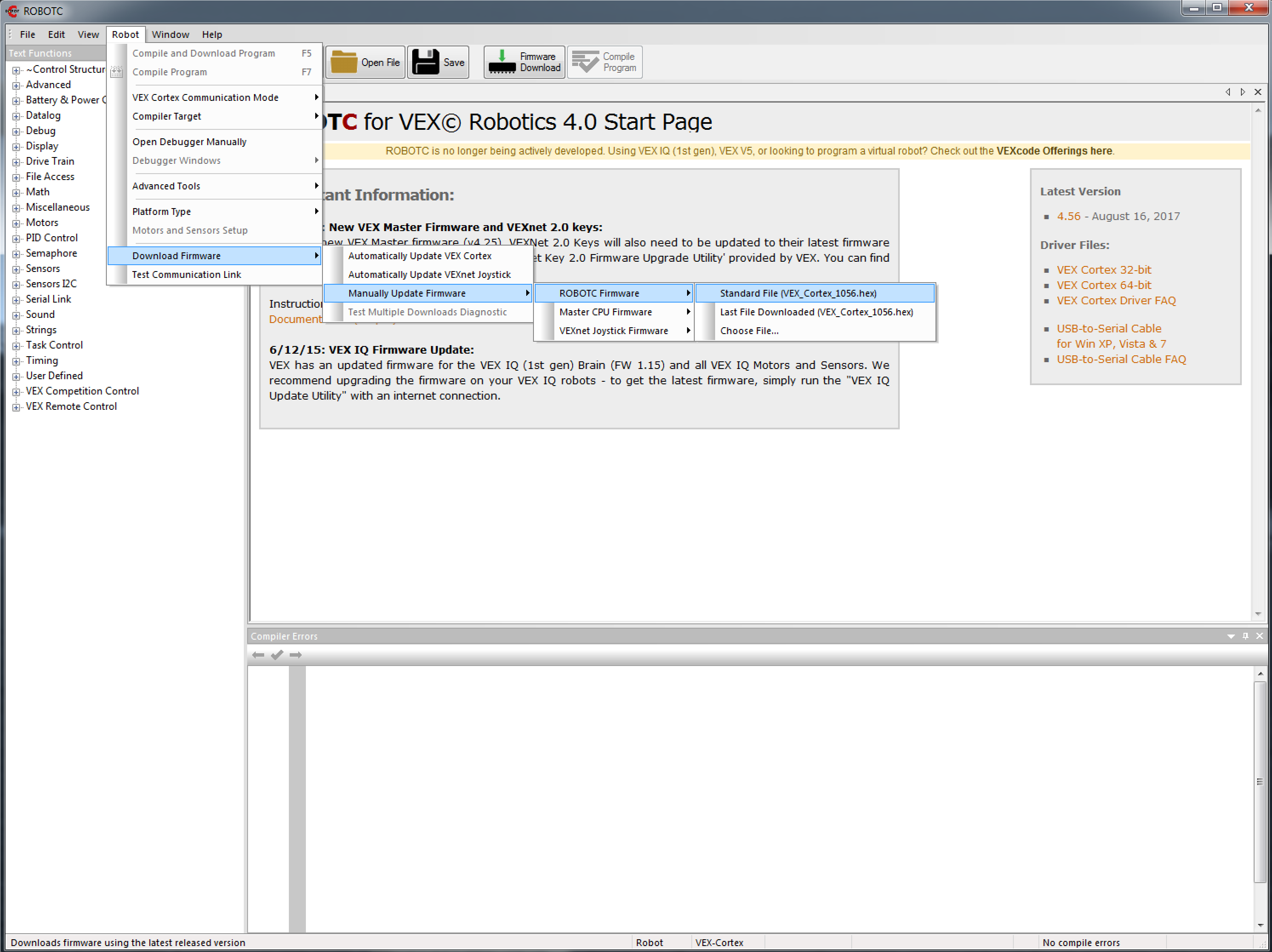

Did you load the RobotC virtual machine onto the cortex ? You need to do that before you can download and run a usrr program.
This is the first I’ve seen it is even a thing. I did see in the complier settings an option to deploy to a VM, but I didn’t/don’t have a clue where to find a VM for the Cortex. Do you have a link you could share. I have found several dead links while trying to pull the legacy pieces together, but nothing for the VM (directly).

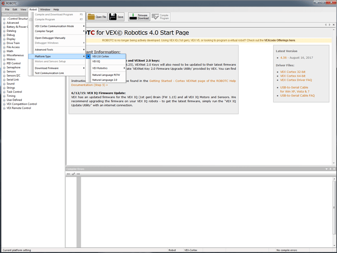

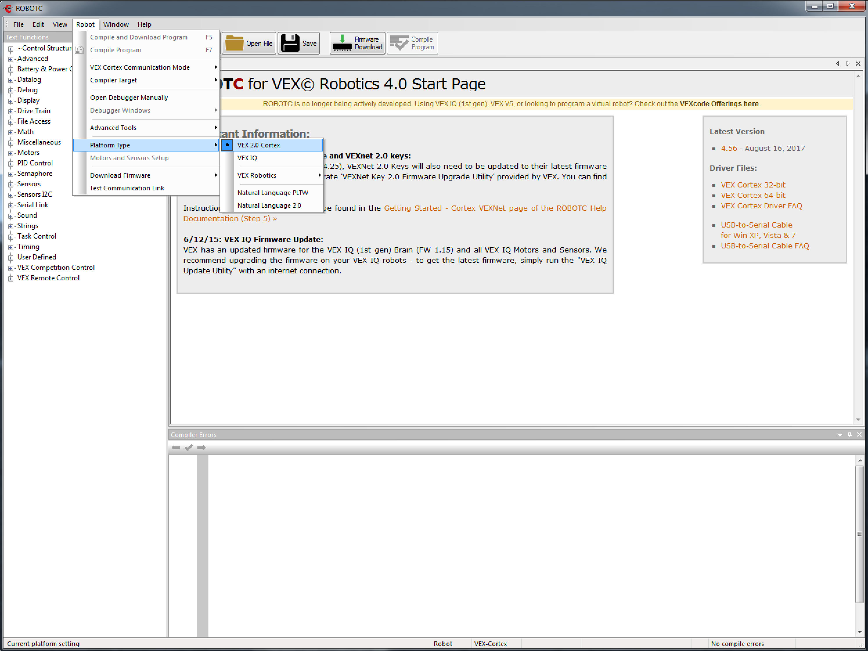

Make sure cortex 2.0 is selected as the platform
Manually load the RobotC VM.
