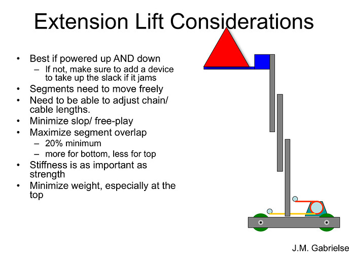

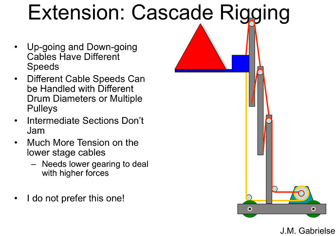

I’m new to vrc and my team could use some help coming up with lift ideas for tower takeover. I was reading through some of the posts and a few of you mentioned cascade lifts. What are those?
Also these photos might help (source: http://www.cornerstonecharter.com/ourpages/auto/2015/12/12/49786536/vex_lifts-1.pdf):
This will help: New triple lift preview

It’s great that you learned about a net type of lift. However, if you are planning on building a cascade lift then I am legally obligated to warn you against using the linear motion kits sold by vex. They introduce unnecessary amounts of friction and are very heavy. You will want to build your slider out of other parts if at all possible. There are plenty of threads detailing how to do this (a good place to begin the search would be dreadnaught from in the zone). This can be quite a rabbit hole though, so be warned. However, this is not the thread for me to explain how to build a custom linear slider, so I’ll refrain from going into any more detail here.
