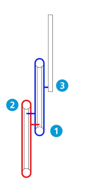

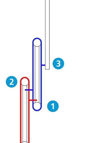

That’s really good for only one motor and an almost dead battery! How is the chain routed through the stages?
looks great. Since the stages all move simultaneously the third stage goes twice as fast. Does this mean it also has half the power?
It might just be me, but the link isn’t working for me. I’m on mobile which might be the problem.
Like this.
Two loops of chain.
The red chain is attached to stage two at position 1. The blue chain is attached to stage one at position 2 and to stage three at position 3.
As the middle section rises it causes the blue chain to move and raise section three.
