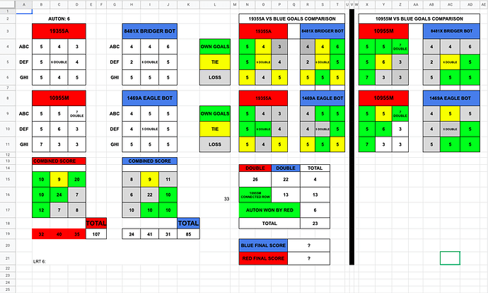

Hello, this is team 10955M MJS Robotics and I would like some clarification about the Live Remote Tournament Scoring. This is the final match scores from the, VRC Live Remote Tournament presented by the REC Foundation. Red Alliance scored 124pts in total and Blue Alliance scored 132pts in total.

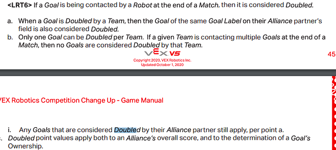

This is the actual layout of scored balls in every goal per team. When I calculated it I got different results from the actual score. With the rule it states that, " When a Goal is Doubled by a Team, then the Goal of the same Goal Label on their Alliance partner’s
field is also considered Doubled." This is how I got 24 points in total for the Red Alliance middle goal.
I would like some help with calculating the score for the final match. Correct me if I’m wrong, but based on my calculations with the graph I’ve provided my scores didn’t match up with the scores given in the final match. Any help would be greatly appreciated.
Edit: A clear graph
