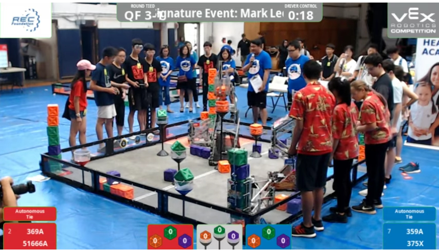

I’m sure I’m not the only one who noticed the long event name getting chopped off on the screen as seen below. Next time, I’d recommend shortening the event name so that it looks better.
Thanks for the feedback, I’ll forward it to my mentor. Is there any way to make the name field larger lengthwise? Is the event name set when the tournament is created in TM?
I think most event names will be longish… these are the names posted on robot events. Maybe TM needs a short name field for the event?

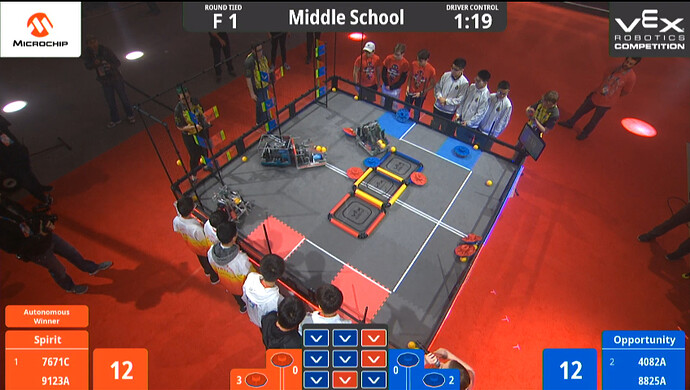

As you may have noticed, we tweaked the in-match screen for Worlds to get rid of the giant gray rectangle with the match name. It’s now smaller and pushed towards the top of the screen so that it doesn’t block nearly as much of the live video.
The space in the middle was primarily allocated for showing the division name in multi-division situations:
In a single-division tournament, the thought was rather than leave that space blank to put the event name there, which was a last-minute change before TM was released this year.
It obviously needs some tweaking on the TM side (it should only cut off the right side, for example). Maybe we even just get rid of it since EPs do like to set ridiculously long names most of the time. But that’s a whole different topic.
In the course of making a stream/audience display look better, it would have been good for someone to notice that it was getting chopped off and edit it to something shorter. You can edit the Event Name field in TM after setting up the event - it defaults to the event name used on RobotEvents.com, but it doesn’t have to stay that way.
I realize this is a setting that you as the webcaster probably didn’t have control of, but if you see something like that again I would encourage you to ask the EP to see if it can be changed in order to make things look better.
