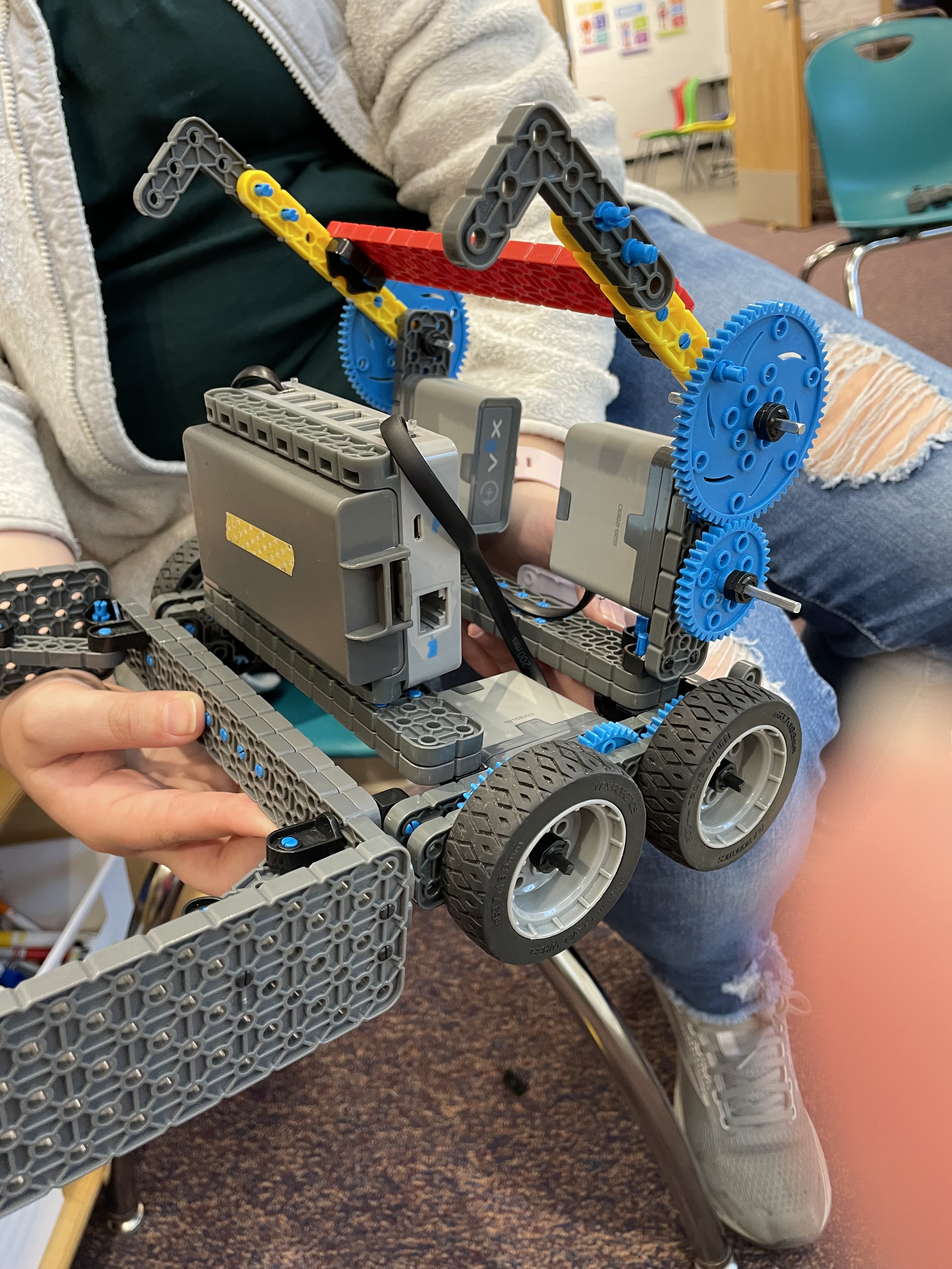

Hi, I’m new here and would love some help with our low hang for Pitching In! Our kids have to hold the remote control while it is hanging at the end of the match and that is not allowed, I don’t think. How do we get it to hang and STAY? We are a new program and have much to learn!
Amy
What programming software are you using? Your students need to set the motors to ‘hold’.
I was involved in IQ back in next level so I have a bit of experience with low and high hang designs. You can create a faster mechanism using less motors and gear by using rubber bands. This was done by one of our teams that year, they did quite well with it.
We are using Vexcode. Do we set the program even for Driver Control?
That sounds intriguing. Not sure how but thank you! I’ll share with my 7th graders.
Try attaching a rubber band to peg on the arm then attach the other side of the rubber band to a c-channel at the bottom of the robot. Do this on both sides. This will make it so when the motors are active you can easily lift the arm, but when the motors are of the arm should retract and make it so the robot stays hanging.
Yes. So, in VEX Code, your students will see the ‘hat block’ (a block with a rounded part on top of it so it can’t connect to any other blocks) that says ‘When Started’. They need to find the block that says ‘set ________ stopping to _______’. They will need to set the first blank to the name of the motor or motor group that is controlling the lift. They need to set the second blank to hold. Then, just connect that block to the ‘When Started’ hat block. Do this in every program where it needs to hold, including driver control. Let me know if that works or if you need some more assistance.
Ah, I see what you mean. Thank you very much!
Great, we will try this tomorrow! Thank you so much.
This really did work for a hot minute! We need to reinforce the bot a bit though. Maybe our arm is not strong or long enough. Still improving–thank you for your help!
