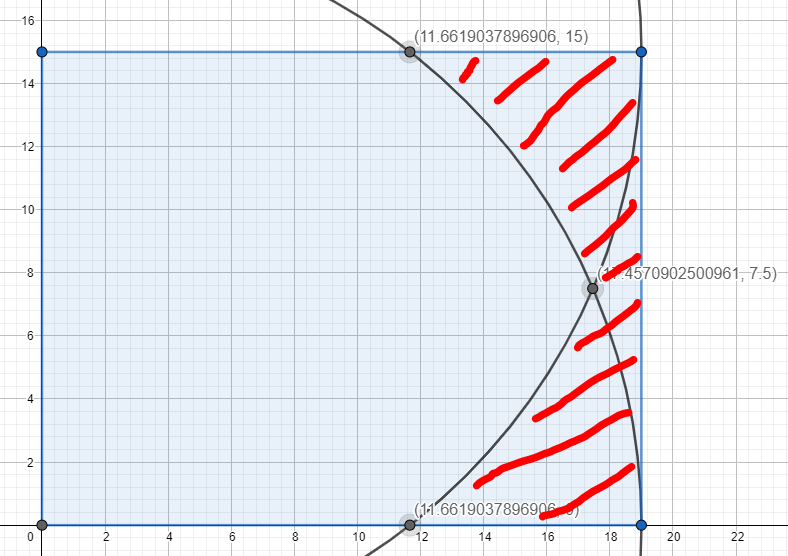

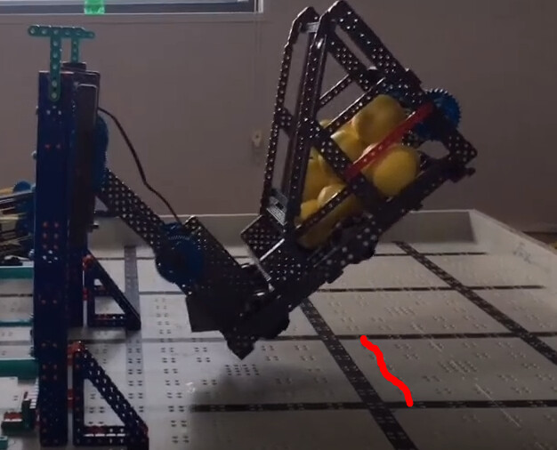

These bots are probably out of size as they rotate up. To check the 19" height, you would roll the bot on the field over its front bumper and make sure it never goes over 19". This design is probably possible, but as it is it probably won’t pass inspection.
So, to make sure it is complying with length and height, the hypotenuse of the bot has to be <= 19".
sqrt(12^2 + 14^2) = 18.44, so a length of 14 and a height of 12 would almost max it out. You could do a little bot more by shortening your wheelbase, but the basket in the back of the bot seems to need to go from the floor where it intakes to the top where it dumps from.
I put up a Q&A’s about this bot in particular and the sizing rules. It seems like teams will assume that the sizing box rotates with the bot… Which is hasn’t done in previous games. Even if it did, the arm that presses against the lower bar would then make it out of size.
We’ll see what they say!
Here’s another shot from the same person. Assuming it’s the same bot. I drew a rough 19" length line on the field. Seems like it’s over by 3-4"

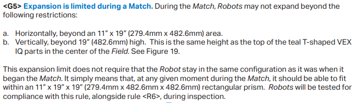

My read on G5 is that the size box absolutely can rotate with the robot. I would test this by having the wheels flat on the ground and running the crane through it’s allowable motion. If the moving crane (& rest of the robot) doesn’t violate the 11x19x19 rectangular prism, then the robot will be legal.

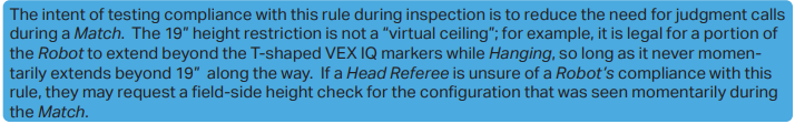

This is how I read it, too. There is nothing in the game manual that says the size box must remain parallel to the floor. The unique wording of a prism of size tells us this is a new concept for this year. Additionally, the “blue box clarification” that says there is absolutely NO 19" ceiling makes no sense if the sizing were with respect to the floor.

My read on the G5 blue box was not that the vertical limit could rotate, but rather that the 19" measurement does not necessarily start at the ground:
  • If the robot is touching the ground, then no part of the robot can be more than 19" above the ground.
  • But if the robot is hanging (and therefore some distance above the ground), then the highest part of the robot could be more than 19" above the ground, as long as the vertical distance from the robot’s lowest point to its highest point is no more than 19". For example, if the lowest point of the robot is 2" off the ground, then the highest point can be up to 21" above the ground.
I think it’s pretty clear based on G3 that “vertical” means “perpendicular to the ground”. If the 19" vertical measurement rotates so that it’s no longer perpendicular to the ground, then it’s no longer a vertical measurement.

In any case, I think the same argument applies to the horizontal measurements as well – “horizontal” and “vertical” are terms that only make sense as defined relative to the field, not relative to the robot. If the 19" horizontal measurement rotates so that it’s not parallel to the ground, then it’s not a horizontal measurement any more.
What’s problematic here is the wording of G5. Although the terms “Horizontal” and “Vertical” are used in subpoints a and b, the rule goes on and mentions the 11” x 19” x 19” (279.4mm x 482.6mm x 482.6mm) rectangular prism, but does not define any of the dimensions in the “rectangular prism” description as horizontal or vertical, nor discuss orientation of the prism. In fact, looking through the past six game manuals, this year is the first time the “rectangular prism” concept has been introduced in the game manual, leading to the possibility that the introduction of the rectangular prism to regulate size during hanging may have been to simplify sizing the robot during the complex translation/rotation that occurs during hanging (and maybe swinging a bit), by offering the concept that a referee could take the robot in the “hanging” configuration, set it on it’s wheels and measure it to see if it’s within the “rectangular prism” size limits. Still waiting on the Q&A…
