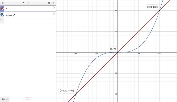

First of all, a normal linear joystick function for a drivetrain looks a little bit like this:
This follows a linear line. If you press the joystick 20%, the motors will drive at 20%. The problem with this is when you are trying to do slight movements, you end up not being able to move without moving to much. It is too finicky for fine movements.
A fix to this is using exponential functions for joystick control.
This is the line 0.0001x³, a cubic line that shares the points (0,0), (100,100), and (-100,-100) with the line x. This line allows for slight movements when pressing the joystick lightly. For example, pressing the joystick 20% only spins the motor at 0.8%, but pressing 100% will still spin the motor at 100%.

This code is able to get the results we want from the cubic line, and is able to do that by multiplying the joystick% by the line 0.0001x³.

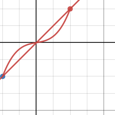

I made something very similar last year and created a formula that can be used to adjust the exponential curve’s shape while keeping the endpoint of the line near 100 100 and -100 -100. Here is the graph if anyone wants to use it.

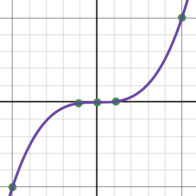

Yeah, you can also use x to the power of 5 or 7 and so on. It will just make the joysticks even less sensitive. Just know it gets to a point where it doesn’t work too well if you use too high of a power.

You can also use even powers if you adjust your calculation to include one instance of the absolute value of the control signal.
I didn’t think about that! This probably works better than a cubed line.
When my kids want to try this, I usually recommend they try both squared and cubed… most go with the squared option.
Yeah, it seems to be the perfect middle ground between linear and cubic.
