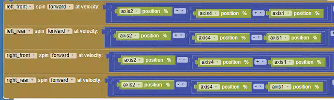

I am currently trying to code mecanum wheels for my robot on v5 blocks and cannot figure out how to do it. I was hoping you guys could help. thanks in advance.
You will need to do this code with 4 motors and you will have to experiment with the axis.

For the Mech Wheels you are going to have to add (or subtract) something to have it strafe in the correct proportions.

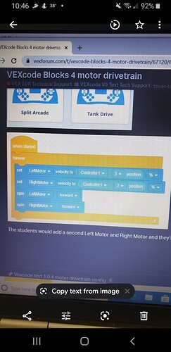

I had kid also set up the bot with tank drive, and then if the moved either stick from side to side it would strafe.
I would not use the drive train because you won’t be able to do the strafing.
Your solution will look no more complicated than when @turbodog posted, but then you will also have to spin the wheels on a separate line.
Figure out how the want the bot to move with what sticks, and we can help you more if you can’t quite get it to work. Try to add in one or two axis at a time.
