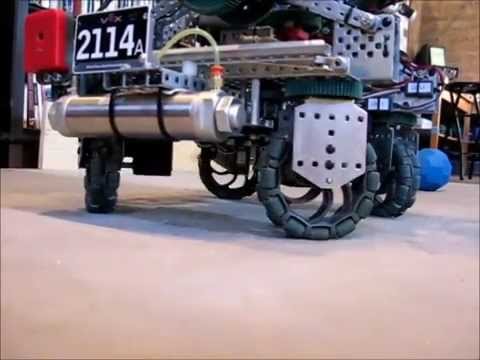

Well, actually, x-drives are faster than tank drives (check out this video). Also, in regard to getting over the pipe, I guess we will see ![]()

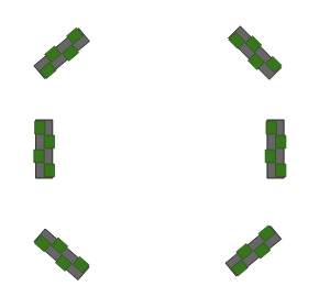

Maybe you can build a modified 6 motor x drive that looks like this. (Edit: called an Asterisk Drive.)
Asterisk Drives are something to consider because I’m fairly certain I want to devote 6 motors to my drive. IDK, seems like I can build a much smaller drive base that would end up being significantly lighter. I’m going for super minimalism this year, just a few aluminum parts, to be as fast as humanly possible

We had both an X-drive and mechanum drive in Toss up, they both could go over the bump pretty easily. The X-Drive did sometimes burn out, but that was with a heavy robot and a much bigger bump than 1". Though I definitely wouldn’t suggest using mechanums.
We tested out the x-drive with our starstruck robot, and it works pretty well for getting over the first pvc pipe. a normal forward facing drive could be better than it, but in reality you don’t need to cross the second pipe so there is no reason.
